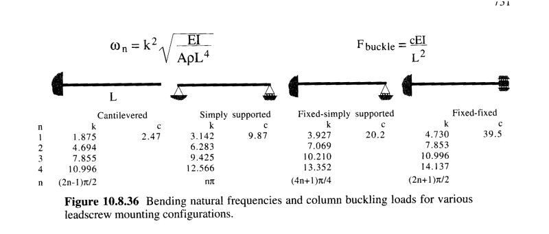

The following picture shows the formula I am following for natural frequencies. This doesn't take in to account mass does it?
The values for natural frequencies vary hugely compared to ansys.
Mass shows up in your formula as density times volume. The formula appears to assume a uniform mass distribution which may well be appropriate.
It does in so far as the uniformly distributed self-weight of the beam (the A and ρ terms - section area and density - in the denominator), but does not include added lumped-masses within the span.
