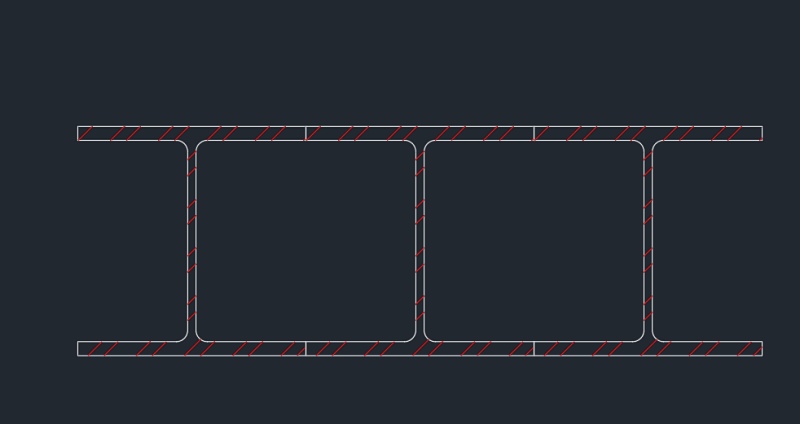

Hello all - new here but looking to learn! We are looking at a scenario where we are wanting to use beams, with internal gussets and welded seams as load spanners. I'm curious how to properly set up calculations to see what maximum allowable loads would be. There are a few different sizes of beams we are looking at running numbers for, as well as different numbers of beam combinations for a couple of scenarios. Picture below for reference.

If I've understood your question correctly, you're asking for the basics of how to design a beam

The tricky part with your installation is likely to be how to force your three side-by-side beams to act as one member
As you've highlighted, some sort of welded or bolted gusset system will likely be your answer
There is a lot of potential nuance to this though as the connection details will influence whether your members behave compositely, as three equally-contributing beams, or some combination thereof
The details will also affect the potential for out-of-plane buckling of your beams, or local buckling of flanges etc
However, the nuances of these details are probably lost if you don't know how to design a beam in the general sense as these effects are a downstream consideration from the global beam design equations
Your note about making the side-by-side beams act as one member is accurate - that is my goal. I've found many resources regarding beam designs, but none clearly define how to go about making them act as one. I'm trying to do this without any analysis software at my disposal, and so I figured I would ask here for resources or guidance. Like you mentioned, there are quite a few nuances that need to be considered and all adding an additional layer of complexity in their own.

logann - you need to define the support and loading conditions on these beams. both down the length and across the width.
you mention internal gussets - what configurations are you thinking? how installed? and why needed?
Greenalleycat - ideally, load case would always be centered and equally distributed. It would be up to our department, in conjunction with the client, to ensure correct measures are taken to ensure as close to evenly distributed loading as possible. I initially called them spanner beams because the application we're wanting to use them for is for the below scenario. Basically we have a couple of self-propelled modular transporters that would carry the load centered on the beams to an arbitrary staging location. Once in position, the trailers would lower the load onto the staging cans and walk out from underneath the beams and the beams and cans would support the load at that point.
swcomposites - the internal gussets are hard to determine exactly at this point and are part of some ongoing internal discussions as well. We are thinking welded where we can because of strength purposes, but we are not settled on that either. Main concern at this point is how to configure beam loading capacity for any combinations of beam size and number of beams we want to run for a given project.
instead of I-sections that are touching at the flanges, why not something like:
- thick flat top plate over the entire area, +
- I-section beams welded to the top plate down the length of the upper flanges, spaced apart so that there is sufficient access between the lower flanges to weld or bolt transverse members, +
- transverse members welded or bolted to the longitudinal beams
