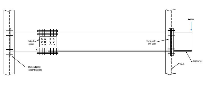

I wanted to know if this is an acceptable detail, for a beam to extend past a column, after which it acts as a cantilever.
Connection is through the web with thick plates.
Intention is for the moment passes through the beam only ... but the web will deform as well.
Is this an acceptable method and is there any literature on this?
Also how would you apply restraints so that moment is not induced in the column at this location?

For information backspan is larger compared to cantilever.
Perhaps interface with column needs to be looked at with FEA. My hope was that a paper was available to provide some confidence in the additional stresses.
Also, I presume it's not possible to input retraints such that moment at this particular location is either zero (or less than full section capacity), from the connection in question.

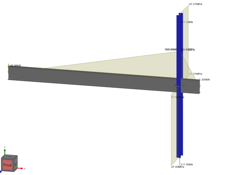

It it should be possible. Though naturally it will depend on your software. I go my software to remove all moment transfer but not shear simply but making multiple nodes and then constraining the nodes together in the vertical plane. (Essentially making the column only connected to the beam in the vertical direction, so no moment transfer.)
A slightly more nuanced approach and you could do the same with a spring and only transfer some moment.
But this really is software specific so I can't advise further.
My quick model with zero moment transfer and only shear.
Same model again but with moment transfer as your would expect.

When I first looked at it my first impression was that yes there would be some rotation and bending in the column web, agree that the wider the column the less pronounced. But how to quantify? For this reason FEA was mentioned.

For all the reasons previously highlighted. The load WILL impart some moment on the column so ignoring this completely could be quite unconservative.
Yes I get that, which is why I said to design the column for the fully rigid scenario, as you've shown in the second model.
Sorry Tomfh. I misunderstood. I takeback what I said there. Your approach seems suitable and conservative.
