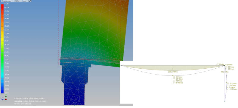

I ran a connection check of Kookt's drawing. In a similar approach to what is described here:
Results were as previous discussed and more accurately describe by BAretired.
-The connection has a calculated stiffness of 24,000kN/rad
-As far as the column is concerned this is a rigid connection, the column takes significant moment and its design capacity drops by almost 50%. If this column has been designed for axial load only this is a significant problem!
-As far as the beam is concerned the connection might as well be flexible
Below is the FEA for the connection and a basic moment/deflection diagram for the two members:

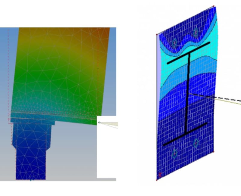

Neat. Questions:
1) How is the flexibility of the bolts captured in such a modelling exercise?
2) Do you not feel that your element sizes are a bit large for something like this? See the sketch below for the mesh on your model (left) versus the mesh shown in the referenced web page that you provided on your method (right). Obviously, if the mesh size is too large, the model will fail to capture flexibility adequately. I'd think the mesh size that you've shown adequate for, say, a beam taken as a whole. But perhaps not a connection where the important distances are small.

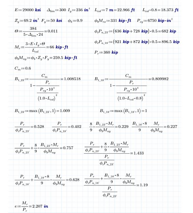

I did a little old school hand design to get some alternate ideas on the table. You kinda have to speak AISC manual design to read this easily and I apologize for that. Also, given that it's 11PM here, there's surely a mistake in there someplace in need of finding. Without further adieu:
1) OP's axial load @ 360 kip.
2) Beam end slope @ L/300 per BAret.
3) Column @ 7m per Human909.
4) No account whatsoever given to connection flexibility.
5) No account given to column stiffness reduction associated with axial compression.
6) Conservatively estimate column moment assuming a column slope matches beam slope with zero moment at the beam end.
7) Load eccentricity is a paltry 2.20 in. One would certainly hope that the original column design included more eccentricity than that.
8) Connection moment increases interaction equation by 43% when column top restraint is ignored (K=1.0)
9) Connection moment increases interaction equation by 19% when column top restraint is conservatively accounted for (K=0.8).

24mm steels bolt x2. So they stretch as per the bolt stiffness. NOTE: They are not pre-tensioned! I would have preferred to add pretension but the model was completing with 0 deflection and zero stress when using pretension. A brief google shows that other people have had issues with this FEA on pretension. Obviously adding an appropriate amount of pretension will make the connection more stiff.
The mesh size varies according to the detail. Additionally I manually changed the mesh size to be quite fine around the bolts to ensure the detail of the bolts was captured properly. I found this to be the best compromise to get it working satisfactorily. (I've now started a run with fine mesh throughout. It might struggle, or maybe it will complete in 30minutes....)
EDIT:
Ok it only took 15mins run time. Deflections increased by 3%. Here is a zoomed in shot on the bearing interface. Deflection obviously exagerated.
Let's hear it for fast computers...
For me, much comes down to that 2.20 in eccentricity of load. If the moment generated by conservatively assuming full fixity in the joint would only produce a modest eccentricity that designers ought to be considering anyhow, I deem the whole thing not of much concern from a connection design perspective. The EOR shouldn't realistically be expecting less moment than this even with clip angles mounted to the web of a pass through column.
Another interesting feature of my number crunching exercise is that, the higher the axial load becomes relative to max, axial only capacity, the less impact the moment has on the overall design for the case where column top restraint is accounted for. In the analysis below, I've jacked the axial load up from 360 kip to 650 kip, or about 95% of pure axial capacity. At that level, the impact of the moment in the joint represents only a 3% increase. And that's with all of the other sources of conservatism still in play.
