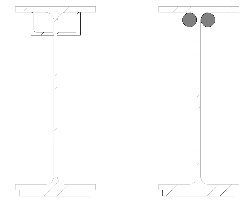

I'm designing reinforcement for an A36 W12x22 with 25-75% section loss due to corrosion on its top flange and web. The W12 is a strut in a braced frame with about 20 kip axial and is also picking up some floor loads with 1.25 ft trib width. Prior to corrosion, the beam is at about 32% bending & axial utilization; after corrosion, it's at about 122%. The corrosion extends about 5 ft from one end, and the beam is in good condition elsewhere. The 122% utilization may be a bit conservative because there's no section loss at midspan. This W12 would be challenging to replace, so I'm looking to repair.
Anyway, would anyone have suggestions for improvement for my attached detail? I'm welding 1/2" plate to the flanges and 1/4" plate to the web. Might be a bit conservative, but I'd rather keep symmetry. Does anyone see fit-up issues with installing and welding plates MK-9P6 after plates MK-9P5 have been welded? Anything I could do better?
Thank you

Can you use round bars in the top fillets and a flat plate on the bottom of the bottom flange?
Also I have seen Angles added in a similar location to the bars that @Dik describes. Your solution requires a lot of preparation for the welds.
Are you concerned with the web as well? those doublers plates look pretty rough to me. If you can get away with just reinforcement of the Top and Bottom flange similar to what @Dik is saying I think thats the simplest. If you have to reinf. the web maybe try to get it on one side only?

1) How much is section is lost is not as important how much remains. In this case, sounds like the 7/16" thick W12x22 flange is now less than 1/8" thick in places... not much to weld on.
2) The proposed 6'6" long repair is welded almost exclusively to the 5 feet of corroded, compromised steel. Structurally, the welded repair may (probably will) "look" better than it is since that part of the existing W12 is in such poor condition.
3) Very good... but, because of the axial load, I suggest keep the repaired section symmetric along it's length, too. That is, extend repair for almost the full 21' length.

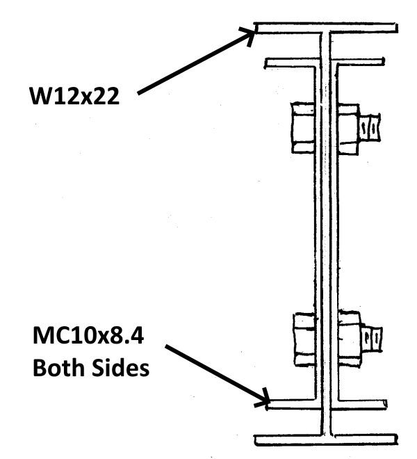

Because of excessive metal loss, suggest a bolted repair instead of welding. Perhaps like this, with the MC10s butted up against the (assumed) corroded connection to transfer axial load to the column without relying on the W12 connection. Shim between the W12 and MC10 flanges, top and bottom, at bolt locations.
Honestly for that amount of work, wouldn't it make more sense to just cut out the offending portion and replace it with a full moment splice once you're back to solid steel?
Always tough trade-off going for a splice vs. reinforcement. At least your proposed repair is all fillet welds, but that is a huge amount of field welding, especially if the section loss is that significant--in the act of cleaning the thing might fall apart.

I like the bolted N.S./F.S. channel reinforcement; however, I do have a concern with the added shims being a new source for pack rust to rear its ugly head. This floor will continue to be wet. I'm a relatively new engineer, but I have seen case after case of pack rust issues in the industry that I work in.
