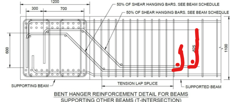

HI all,
Long time reader, first time poster here. [glasses]
I have a beam-to-beam connection with large shear forces. This is in Canada to A23.3. Hanging stirrups in the girder are too closely spaced to fit in the 'hanging zone' because only 2 legs out of 6 would be effective.
My proposal is to add inclined bars to carry the shear force "up" into the girder so that all 6 legs of stirrups are effective. Any and all feedback would be greatly appreciated.

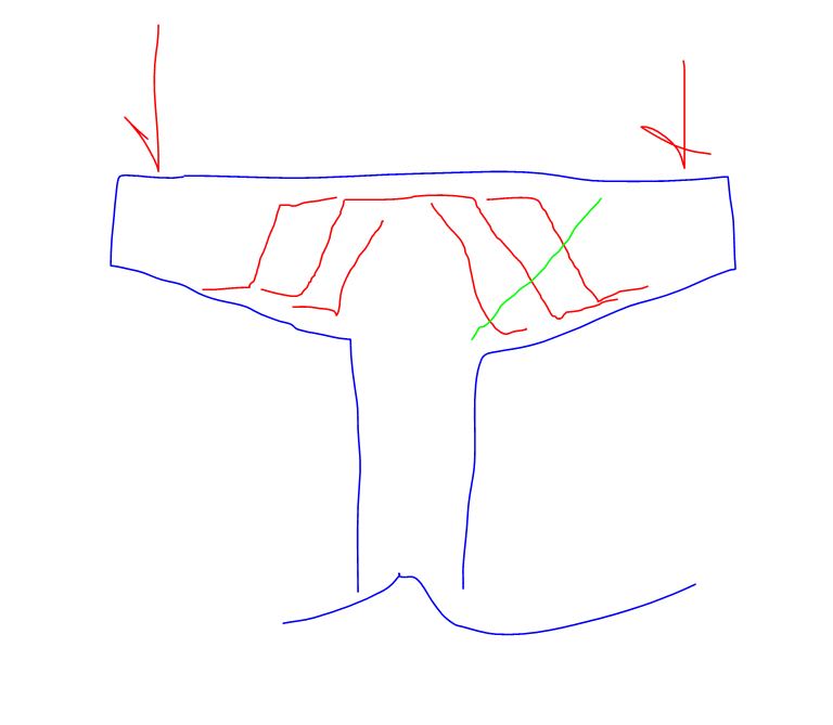

OP, I do not think I understand you fully. In the post where you replied to me you drew a red line where the crack forms - how does adding a diagonal bar change that crack? If it does not change it, then the leftmost vertical will never be able to cross that crack and it will never activate. This was the original idea, right?
IMO all the deiagonal does is that it adds more steel area that resists shear and this will help with congestion.
As KootK said, it's a weird strut and tie when you start to mix it (I don't know how to form it really), but I think that it would be safe to say that the mechanism does not really change and just add the projection of the diagonal steel area to the vertical steel. This would retain the same shear truss, but the tension vertical would be "larger".
It doesn't prevent the crack. Rather, it drags some portion of the shear load up above, and over to the left of that crack. Just as a conventional beam stirrup does. This creates a new critical crack which then, hopefully, would see the associated compression strut engaging the stirrups farther into the interior of the beam.
To clarify my own position, I don't question whether the trapeze things work. What I'm unclear of is how to quantify their benefit rigorously in the context of modern design provisions which include strut and tie etc.

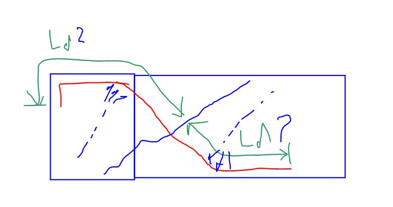

That, then, becomes the crux of my concern. How does one ensure proper anchorage of a trapeze in your opinion?
I don't know but have the following thoughts:
1) For #5 or smaller, I'd provide a standard hook and not worry about it. This, based on the precedent set by our practice with normal beam stirrups. Granted, these are probably not small diameter bars.
2) Do a full on strut and tie design including curved bar node stresses at the bends etc. I see no one do this ever. And I suspect that there are parts of the model that would be incomplete and/or would not check out.
3) Develop the bars on either side of the presumed shear crack by utilizing the portions of the bars beyond the bends as well as the straight bits. Note that this is a method that is code sanctioned in some countries but, to my knowledge not in the US or Canada. And where it is sanctioned, I believe that it requires some attention to the bend radius to prevent concrete crushing.
The approach taken will have important implications for the detailing and placement of the trapeze bars. It may also make them somewhat sensitive to field placement issues.

Regarding your concern 3): it should not be that hard to make a larger bend of the bar... with the bend radius of 15D #8 bars spaced laterally at 4" in 4000 psi concrete should be able to develop roughly 60 ksi (based on Eurocode). Adding a transverse bar (as OP has in his drawings) should also help significantly.
I guess you don't really need to develop 60 ksi at the bend since most of the force is already anchored.

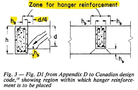

What is needed is a hanger assembly capable of carrying the factored reaction of the supported beam. The most direct method is a group of vertical tension bars in the overlap area of the carried and carrying beams. They must be mechanically anchored top and bottom; and they should be confined by horizontal ties crossing the potential crack.
I appreciate everyone's responses and interest in the subject!
bones206, thank you for the reference document. Very informative. Also noting that earlier version of this requirement extended the 'zone of hanger reinforcement' by as much as d/4 into the supported beam for beams of equal depth...something that the current revision does not.
KootK, to address your comment about lack of a 'robust mechanism for checking', I agree that this is, in general, an incomplete truss-and-tie set-up that doesn't carry the load to any definitive end. This being said:
1. Both the supporting and the supported beams have all the required one-way shear and torsional reinforcement stipulated elsewhere in the design guide up to and through the intersection.
2. The diagonal bars are in addition to all other transverse reinforcement and are required to address the discrete issue of the concrete breakout in a hanging beam scenario where rebar congestion is an issue.
3. Given 1&2, if the concrete breakout failure may be addressed by the additional diagonal bars, then all other reinforcement will still be there to ensure that other modes of failure do not occur. For this reason, in my opinion, a truss-type 3D model that aims to replicate all developing struts and ties may be avoided once the diagonal bars are extended/developed outside of the 'zone of interest', and if all stirrups in the supporting beams are engaged.

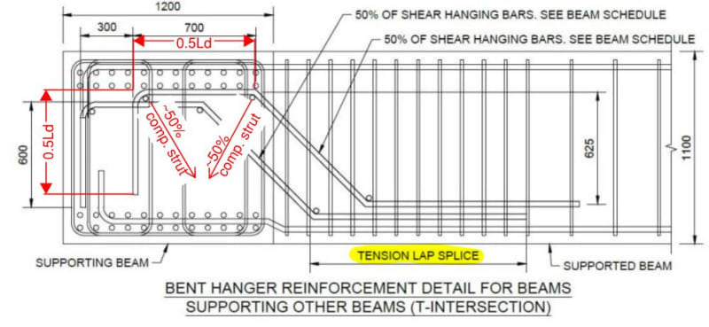

Regarding forces, placement, etc.
- Compression strut check as per strut-and-tie model. yes. This is one of the reason why two offsetting rows of bent bars are proposed.
- The bars to carry full shear across the interface at an angle of 45 degrees. Rebar force = 1.414xVf.
- For the T-intersection case, arguably the more difficult of the two being discussed, the bars are fully developed before the first bend in the supported beam. Tension splice is what I actually called out.
- For the end of the bar in the in the supporting beam, I consider that ~ 50% is developed before the first (90deg) bend and fully developed before the next (45deg) bend. This way I rationalized approximately equal forces between the 2 forming struts in the supporting beam.
- The force from the diagonal bar should create torsion in the supporting beam. This torsion being no different to the force caused by eccentricity of compression strut in A23.3 CL 11.2.12.2 about center of the supporting beam. Transverse reinforcement to resist this force should already be there as prescribed by other clauses of the design guide.
Some testing and prescriptive guidelines would certainly instill more confidence...as for anything else I suppose.
