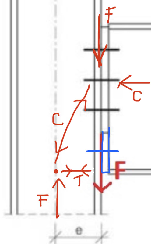

I have a question regarding a beam to column (hinged) connection (see the attached file).
The beam transmits a reaction F to the flange of the column with an eccentricity e from the centerline of the column. Should I check the column with a bending moment M = F*e?
Thank you in advance.

1) I do believe that the moment ought to be designed for, just as you've proposed. Whether or not that's common practice kind of depends on where you practice.
2) Through my participation on this forum, I've learned that some counties' standards explicitly direct designers to consider this moment as well as some moment from the eccentricity to the bolt line where the detailing includes that (yours doesn't). I believe that things work this way in AU and NZ. Not sure about Eurocode.
3) In my experience, it's pretty common to ignore these moments in North American practice. And there's some justification for that:
a) If you're not designing your columns to the nuts axially, there's a little margin there to cover this kind of stuff. Less so with automated design now.
b) The depth of the connection and the nominal fixity provided by it will tend to shorten the effective length of the column somewhat. There's truth in that but it's still a bit awkward in that you're weighing a benefit that you don't explicitly quantify in routine design (fixity) with a cost that is tangible (F*e).
The paper shown below supports this perspective to a degree although, in my opinion, it's kind of got the feel of "We like ignoring the axial load eccentricities and would like to continue with that".
I'm of the 'other camp' that Koot refers to... I usually make sure the moment attachment of the bolts is OK to accommodate the shear load times the eccentricity to transfer the eccentricity of the load to the column centreline... specially if the beam stiffness is much greater than the column stiffness... forgot to add that for HSS sections, I use slip critical connections, usually...
Yes, you should design for this moment.
I always wonder however that since the beam “applying” the moment is also the same beam effectively restraining the column at the point which the moment is applied, how much moment really materialises. But that’s yet another make & break thesis I’d try if I were back in college now! Regardless, to answer your question - yes.
If I were to justify omitting this, I could probably do some version of the attached sketch resolving forces around the bolts (so as you can see, your connection needs to be reasonably stiff, full depth end plate - not a pure hinge style pin!). I’ve taken an arbitrary diagonal line through the centroid of connection, you could probably refine this taking a number of diagonals to each bolt row.
But your code might still ask you to account for the moment anyway - mine does and I’ve always just accounted for it.
Edit - my T tension force might even be at the last bolt row... I dunno, I’d have to think about the plate stiffness..
I get sick of agreeing with people especially Kootk. But I concur.
Should you check it? YES.
Do I always (and others) check it? NO. (despite code requirement) For pretty much the reasons Kootk has said. There is enough conservatism elsewhere to cover it in the vast majority of cases.
Likewise with beams. The reality is that shear plates (or angle clip plates) still can put a decent amount of eccentric load on beams. In most case this all washes out because any twist due to the eccentric load is counteracted by axial compression in the beam applying the load. Though this isn't always the case, in some cases if not properly accounted for can really cause severe torsion on a beam.

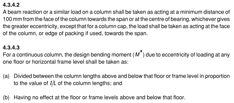

In NZ and AU codes for 'simple' construction (i.e. nominally pinned connections) connected to the face of columns, we are required to design the column for the shear acting at an eccentricity of half the column depth + 100mm or at the centre of bearing (whichever is greater). The moment is distributed based on the stiffness of column within the storey above and below, the design check is considered on a floor-by-floor basis in isolation treating the top and bottom of adjacent storeys being pinned to determine the moment diagram. The checks governs sometimes with higher axial load utilisation ratios, especially with heavy shear connections. I believe the additional eccentricity to consider is a nod towards pinned connections never truly being pinned, and the point of inflection is some distance past the line of bolts in reality. This additional eccentricity is only considered in the design of the column, not in the connections itself.
It seems like a logical way to check columns in simple construction if your code has no specific provisions.

My opinion on this is that this eccentric moment should be accounted for EITHER in the column or the connection, but that it's not necessary to design them both. That's my general view with pinned connections in general.
I think we often get away with not doing it for a few reasons:
a) The columns are frequently a little over designed anyway.
b) These gravity only columns are frequently laterally restrained by the slab or deck anyway, decreasing how much they can legitimately move laterally.
c) Usually the pure shear connections like this are a little over designed as well. And, it's really only the top bolt that would experience combined tension and shear (which is where we start to get nervous).
d) Even if you impart tension on the top bolt per your analysis, is it really enough to overcome the pre-tension force in a fully tightened bolt?

I learnt a long time ago to always include eccentricities due to poorly noded connections, whether it's a simple shear from a beam or a more complex arrangement in a heavier braced connection. Relatively small moments especially about the minor axis of columns (narrower UB's sections especially) have this habit of using up a disproportionate amount of the available capacity as you're usually sailing quite close to the wind on buckling under axial load about the minor axis.
It's just my preference, I don't care if the design segments have a capacity/demand ratio of 1 at the end of the process, provided I know what loads when into the capacity checks and that I've done my best to account for everything that should be accounted for including eccentricities I'm happy. Could I tell you how many times I had to bump up the column weight or size because of the requirement, not really, because that would involve checking it without the eccentricity and it would take longer....
I've peer reviewed plenty of external projects where people are very blasé about intentionally introducing sometimes quite significant eccentricities into connections and never once checking what the effect is. Many times they based their ignorance of the effects by deeming that there engineering judgement is up to scratch.
Many times the designer is asked to assess further, resulting in increasing member size or modifications to the detailing to achieve sufficient strength for all the permutations of the loading.
Moral of the story as far as I'm concerned is unless you actually check, you really don't get a feel for the effect of the eccentric loads for your particular situation. You don't know what you don't know.
Check several of the more critical locations on a job, and see how it pans out and go from there, eventually getting to a point where your judgement might be applied with some guidance from prior results, rather than ignoring completely! Sometimes it's just a matter of the designers not really understanding what they are doing, others are deliberately ignoring and sticking their head in the sand.
