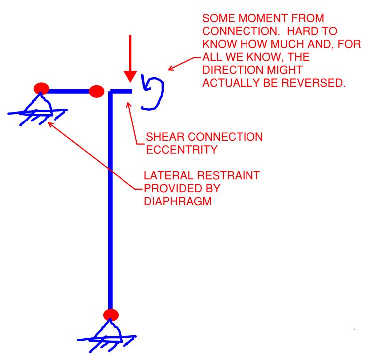

Hi all,
I have a question regarding a beam to column (hinged) connection (see the attached file).
The beam transmits a reaction F to the flange of the column with an eccentricity e from the centerline of the column. Should I check the column with a bending moment M = F*e?
Thank you in advance.

Lomarandil said:
If the connection (and local effects on the column, which I include in connection design) are designed to transmit the forces and moments to the column centerline, haven't I replaced my physical beam with an 'effective beam' spanning from node to node? In this case, what is left for design of the column?
How would that preclude moments developing within the column? I would argue that it doesn't and that you'd still have this to contend with in the macro-design of the column:
1) Combined axial and flexural stresses throughout the entire length of the column and;
2) Exacerbated P-baby-delta moments within the column associated with the flex induced in the column. This leads to a lower buckling capacity.

Obviously I can't read you guys' minds. I'm going to try though. These arguments sound to me like analogs to a common concrete design strategy: If I design my concrete thing to span to the center of the supports, I can ignore the torsion in the supporting girder.
That argument is substantially valid. However, when we do that, we also provide at least compatibility torsion reinforcement in the supporting member. And there's no analog to that in the case of steel post design. In steel post design, we are not taking any steps to ensure that the member as a whole has redistribution capacity.

So you don't design your posts for all of the eccentricity but, rather, some of the eccentricity? How do you decide how much?
canwesteng said:
For a column where the beams framing into it form part of diaphragm, I don't see an issue having the connection transfer small moments so that the reaction occurs at column CL.
How do you see the diaphragm altering the situation? I see it as shown below which would have no impact on the stability design of a typical gravity column.
Moreover, how is it that you have any certainty that the reaction is coaxed into occurring at the column centerline? Your providing the capacity for a nominal moment connection at the joint is no guarantee that the structure will choose to exploit that 100%. You know, the stiffness thing.
Well, I don't think LTB occurs - before that there is certainly going to be a loss of stiffness. In any cases, where we have clean, ductile failure modes seems like an odd place to trying and button down the exact behavior - especially when column base plate are essentially end plate moment connections that we model as pins, and often concrete breakout would govern their failure. Taken further, do we need to look at the fixity in gusset plates adding moments to braces? There are probably a limitless number of examples where we design a ductile material by providing a lower bound solution, and rely on the material to behave as we've decided. Now in situations where this ductility has been overstated, certainly some failures have occurred.
Maybe an error in wording - I'd add all the eccentricity to it. Although we also have vertical loads on both sides of the column with counteracting moments, so in order to see a moment on the column you need to have an unbalanced load reducing column capacity anyway.
In the case of the diaphragm, the P-big delta effects from this eccentricity don't occur, only the P-small delta effects, which if you're happy to ignore the eccentricity then as a result you're happy to ignore these as well.
