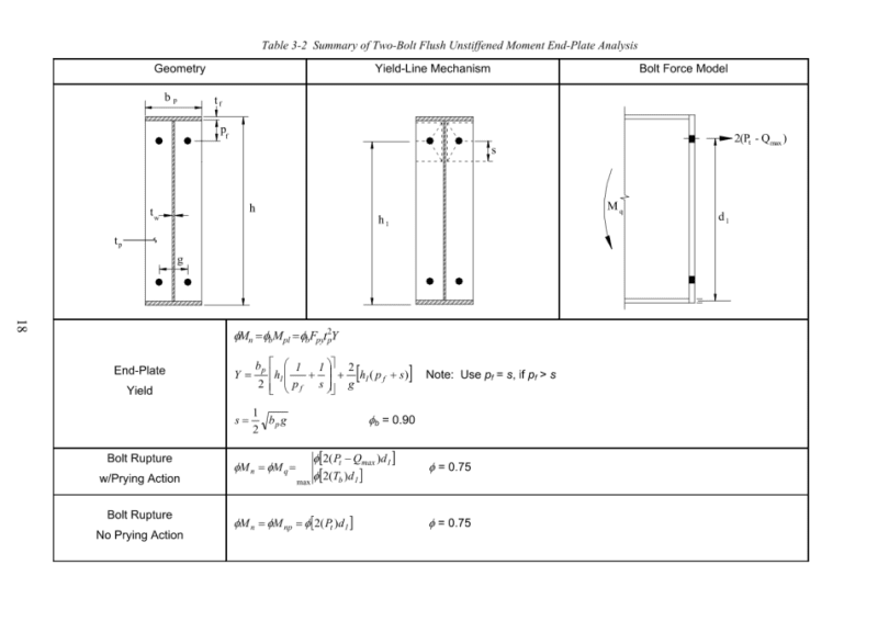

AISC DG 16 has a way to design this connection for moment as well.

I second what Straub said. I'll also point out that connections like he shows from the AISC design guide would be considered "partially restrained" moment connections. Whereas, connection 2 (form the OP) would be considered a "fully fixed" moment connection.
The difference being an AISC classification related to rotational stiffness... alluded to by human99 and KootK.
As Straub notes... I have SMath programs for this configuration, and is good for small and medium moments. A325 bolts can develop a fair tensile force.
The connection on the left is a flush moment end plate as some have mentioned. If the plate is thick enough, it will behave as a fully restrained moment connection. In Design Guide 16, Equation 2-7 is used to compute the required thickness of the plate. It has a gamma_r factor that is used to make sure the plate is thick enough. For flush, gamma_r = 1.25. For extended, it's just 1.0.

I think the right sketch would be a four bolt unstiffened connection, which is still classified as partial moment restraint. To be full restraint you need 8 bolts for the tension flange in a 1/3 configuration, or a stiffener.
