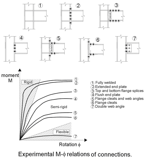

This can help you a bit...Refer to snap below..
Thanks in advance!!
I'm surprised there is as much difference between 2 and 3.
Not sure how true to the test specimens are, but the flush end plate is missing column stiffeners...
I'm surprised of how low no 5 is, is that due to bolt slippage and angle iron deformation?
There's a fair flexibility in the bolt through the angle leg...
This is honestly a shocker, I would've expected 5 and 6 to beat 4 by a wide margin. Thanks for the table Veer!
msl... It's the flexibility of the angle connection.
I have a feeling some of the surprise here comes down to regional differences in the standard ways of doing connections thus people assuming that they are suitable.
There is very little likelihood that connections 5 & 6 would ever be considered moment connections where I work. I wouldn't say engineers are more knowledgeable around here, the reason is that angle cleats are mostly not used and if you called up a moment connection like that you'd get questioned heavily.
Conversely, we use bolted fin plates around here as 'pinned' connections. They are less close to being an idealise pin than a angle cleat.
(Likewise the industry body here doesn't have any guidelines for flush moment end plates. So generally flush plates are not considered a suitable design for a moment end plate. Despite as pointed out if you have a thick enough plate you can likely achieve enough rigidity and possibly enough strength.)
Yes, some people use the angles as semi-rigid connections around here. I've heard of it being used as a quick fix solution to lateral problems in existing structures, not an initial design. 3 is used pretty much universally in my region for new steel.
I thought that the ~1.5x larger moment arm would have made a big difference. But thinking about the flexibility like dik mentioned, I could unfold the angle to a long plate with bolts at the far end, which wouldn't be rigid at all.
I would imagine if you added a triangular stiffener in line with the beam web to the angles in #5 it would improve the stiffness, possibly up to #4's curve.
@Veer007: what document is the source of that graph that you generously posted? There are indeed a few surprises in there.
