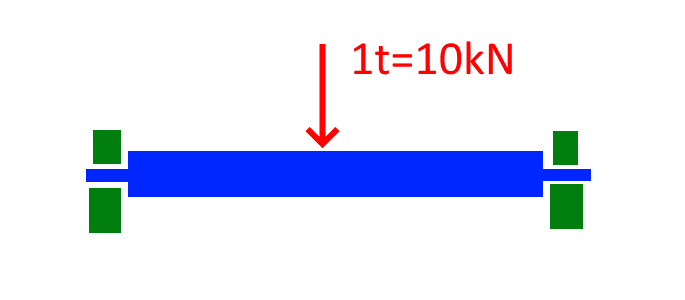

Hi there,
I come with a basic question. I have checked in google but I'm still confused.
We have a load of 10kN. It is supported on both sides with block bearings. So 5kN per bearing. 500kp
We just want to to rotate it 180º. Slowly. Not often.
Checking from a catalogue:
I look at the Bearing Load Rating Static Co and I see they go from 6,2 to 53,3 kp
This can not be. They can't take such little load
Is this an error? Am I missing something and the Bearing load rating static Co is not the number I have to look at??
thanks
regards,
The static load rating on the bearings is related to the number of rolling elements and their contact area. Switch to a roller bearing of some sort for a higher static capacity.
also, there is a re-rating possible for oscillating loads
I found out that it is an error. It is kN. When changing the language of the page it shows kN.
In any case I will look for the proposed rollers
thanks
regards,
