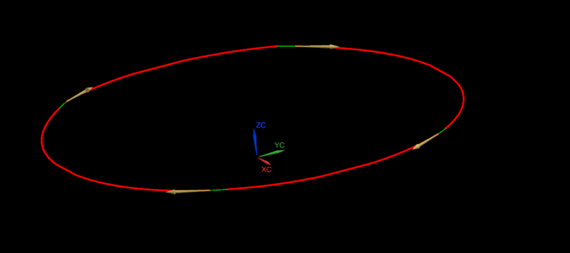

Hi!
I'm pretty inexperienced with NX so I wanted to hear your thoughts on the best way to approach this task.
See image here.
[ul]
[li]I want to generate a volume that connects two closed curves, let's call these curves A and B.[/li]
[li]I think I will probably be using Ruled to create this volume.[/li]
[li]The coordinates for the points in A and B come from two different files.[/li]
[li]Curves A and B both lie on parallel planes, but this is likely not relevant.[/li]
[li]Curves A and B have the same number of points, N. Please note: N might be large, so manual per-point operations should be avoided.[/li]
[li]The curves are made up of straight line segments, not splines.[/li]
[/ul]
I think that's about it.
I already have experimented creating a text file, A.asc with some X Y Z coordinates, and they import as non-timestamp geometry. If I import the second file, they all get lumped together in a non-descript way, so I think I need to make my curve before importing the second file.
I do not yet know how to make a curve out of points using straight line segments, only a spline, which is not what I want. How can I do this?
I am assuming that Ruled will take curves A and B and generate the volume I am interested in, i.e. solid body. Once this body has been created, I will be performing boolean operations on it.
I am open to using a journal script in NXOpen to accomplish this if necessary.
Please let me know if I've missed something in my problem statement!
Thank you!

Bumping this thread because I would still like to know how I can, in one action, join multiple non-timestamp geometry points by straight line segments into a closed curve.
I realize that I never said how to do this...
If you use the old spline creation tool, it has the ability to create a linear ( degree 1) , multi segment spline.
it's a dialog series that will be retired sometime in the future, ( you will notice why when using it... :-) )
Use the command finder ( top right on screen ) search for "spline". Scroll down until you find the one named "Spline (to be retired)"
will start a dialog w 4 buttons : By poles, Through Points, Fit, Perpendicular to planes.
Select the Through points,
tick : Multiple segments, Curve degree = 1, Closed curve = yes ( in this dialog , you can load an ascii file w point coordinates. ) OK
new dialog w 4 buttons , select the "Chain from all" ( NX will search for the next closest point from the one that you select)
new dialog, cue text bottom left corner of screen "Select start point" , pick point in profile.
( remember when selecting these 2 ( or "n" ) series of points to pick this start point "in line" since NX will match these between the sections.)
after selection , NX will ask for end point , pick "the next point" from the start selection

Unfortunately I am running out of ideas on how to solve this problem. I realize the topic has strayed a bit from my original question, but I think there's value in keeping everything in one place.
I imported my point file using a script found on NXJournaling.com. I will paste the script at the bottom of this post. The script reads the point file line, creating lines between these points. This worked great for one dataset, and Ruled was happy, and saw each of the two curves as contiguous and sequential. The problem is with my second dataset of two curves. It looks contiguous, but when I select one of the curves (or rather, series of line segments) with Ruled, I get this:
As you can see, Ruled thinks there are 4 curves. Also, Ruled says there are only 200 segments, but my point file contains 248 points.
The points lie very close to the z = 0 plane, so I calculated ATAN2(x,y) and sorted the dataset by that value. That way I am ensuring each line drawn comes after the previous one, tracing out a rough circle. I have even printed out the distance between adjacent points, trying to catch weird jumps, but there's nothing apparently wrong: the distances between successive points changes, but smoothly. The only remark I can make about these distances is that there are 4 instances in the dataset where the points are very close together, on the order of 1E-6 mm. EDIT: I removed the points that created such a short segment and this did not fix the issue.
Any suggestions? Is there a way I can preprocess these ~ 248 line segments into something more palatable for Ruled?

please_dont_crash said:
...the points are very close together, on the order of 1E-6 mm.
Here's my guess:
When the point distance is less than the modeling distance tolerance, NX does not create the line. Your data has several of these short segments in a row, which then creates a gap that is larger than the ruled command's chaining tolerance. Ruled then sees it as multiple segments rather than a single chained entity.
My suggestion:
Determine the tolerance value that you need to use to manufacture your part, change the NX modeling tolerance to 1/5 ~ 1/10 of this value. Bear in mind that smaller modeling tolerances will require more compute cycles and can make it more difficult to match up surfaces. Now, when processing your point file, ignore any points that would result in a line less than 10x your modeling tolerance.
We often fall into the trap that "more is better"; when in reality, the opposite is often the case. Adding more points (or poles, or guide curves, etc) often results in surfaces that are heavy, "wrinkly", and difficult to work with. Too few points and you don't capture the desired shape; too many and you introduce imperfections into the result. Shoot for the sweet spot in the middle.
www.nxjournaling.com
Thanks for the input, cowski.
I'll try skipping lines in my point file script to increase the distance between points, but do note that I don't think this is the solution for the following reasons.
1) I already removed the 4 offending points that had the 1E-6 mm spacing and it did not affect the outcome.
2) There are two point files in my dataset, and the second one has much larger spacings. The smallest spacing is about 32 mm, and this point file also has the issue. That said, it also has four 1E-6 mm segments, so I will remove those and test right now.
However, you might be onto something with the "several short segments in a row" issue, because as can be seen from the image, it isn't just a break in the selected curves, but there is an appreciable gap that is simply not selected.
Luckily this is not going to be used for a physical part, so I have more freedom to use fewer points/larger tolerance.
I'll report back.
Update: removing the four tiny segments from the point file with the larger spacing worked!
