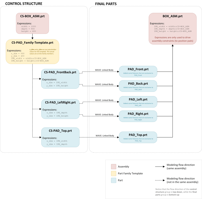

My only question is how to include Part Families in that workflow. I'm uploading a picture of what I tried:
It seems cumbersome and I can't get it to update properly. Seems too complicated. Notice that the part family members are not in the same control structure assembly (actually, the family members are not inside any assembly, they're just isolated parts).
I wonder if the problem is that I'm linking family members to the final parts. Isn't that supported (due to they being read-only or something like that)?
Doing the same thing, but without part families, works fine. But in that case I'd loose the ability to change just one part (the part family template) if I want to replicate the changes in all of the pads.
The way I want it to work is: if I want to make a change in all of the pads (like adding mounting holes, lightening cutouts, adding or changing bends etc), I can just edit the part family template (CS-PAD_Family-Template.prt), then the part family members would auto-update and, finally, update the final parts. If I want to make changes exclusive to each of the pads (like adding a small cutout with our brand logo only in the front pad, or add some mounting holes that are exclusive to the top pad), I could edit only the final parts (PAD_Front.prt, PAD_Top.prt...).
Is there a better way to do that? Would Product Template Studio or Reusable Components solve that problem in a simpler way?
Edit: added the image file as a PDF attachment for better resolution.
Control Structure PDF
