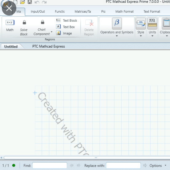

Try Mathcad or similar engineering calculation software.
The free version of Mathcad, I don't recall what they name it, is sufficient for basic structural calculation.
I have historically been one of MathCAD's biggest fans. And I still maintain an expensive subscription license because I like it that much. That said, I no longer promote MathCAD Prime or it's free cousin MathCAD Express for use by others in production structural engineering environments. Prime is just too expensive and they've adjusted the watermark in MathCAD Express to now be an obtrusive thing that cuts diagonally across the page rather than just an unobtrusive footer thing. I'll still use Express occasionally as just sort of a desktop calculator but that's about it.
In my opinion, this "watermark terrorism" is effectively PTC reneging on their previous commitment to offer up free versions of MathCAD suitable for professional use in perpetuity. And yeah, I do know that one can still obtain older versions of Express without the watermark with a little effort.

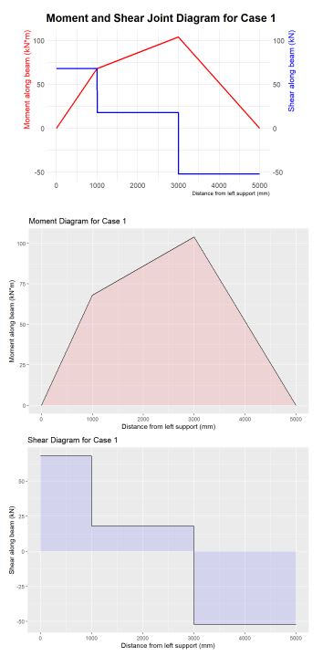

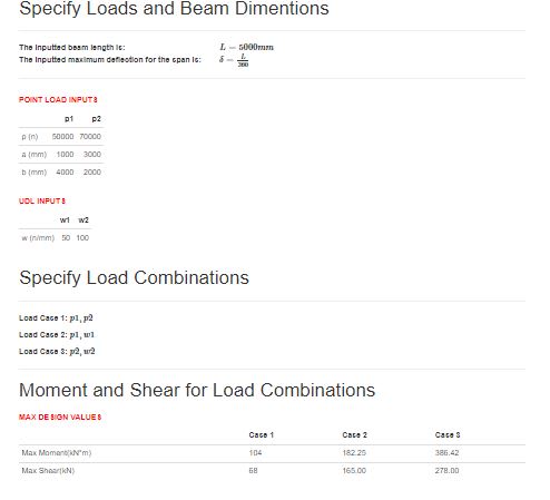

I use / prefer R for pretty much all notes / calculations. Coupled with RStudio and Markdown capabilities, you can make a stellar looking display with control over pretty much everything. R can do all your calculations, which you can hide in the background if you want, and at the end you can print a nice looking graphical sheet to have as an easy reference.
I use R for both design, and project note keeping.
Enable, do you have an example output you can share (like what can you create when printing to PDF for example, whats the end result). I never in a million years would have tweaked to using R for this, but I guess without having looked into it that is a bit like a Jupyter notebook like experience?

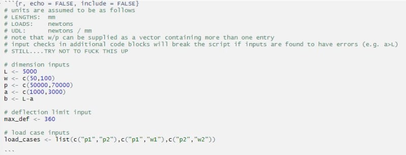

Agent666: My background is as much in statistics as it is in engineering, and in academic stats R is widely used. That's why I've defaulted to it over the years. However, these days with the ease of RMarkdown / Bookdown I really do feel it's a great tool that can be used more widely in this industry.
I personally like it because of the ability for data manipulation, referencing across projects or within projects, and for its graphical capabilities. I'm currently in the midst of making bookdown sheets for all my projects. You can see the power of it here. You can have a description section, analysis section, hand notes section, whatever and have everything hyperlink to one another. Plus it's very easy to modify if you want to add something later. On the two jobs I've done it thus far it has been a dream.

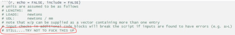

I'm not at my workstation at the moment so I only have access to older sheets / defunct things that don't quite work. But here's a snippet from what I have that should give you an idea (i've also attached a HTML knit file that you can see as well)
R code input. If you want to be fancy you can have popup prompts in the sheet for you to input values instead of into the R interpreter
Basic layout of some of my first sheets
