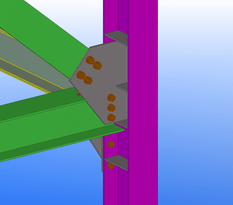

As the subjects suggests , this joint has been giving me headaches.
In the direction of the column main axis, I have a moment connected main beam and I need the back transverse stiffeners in the column.
How do I connect the strut and brace in the other direction while maintaining erect-ability of course .
I've seen the following 2 samples connections before, so can anyone give me advantages and disadvantages of each ?
what checks may be critical that might pass me by ?
or if there are any other suggested shapes.

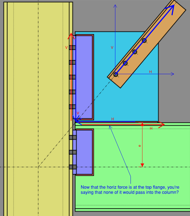

I think they mean the horizontal load from the top bolt Group causing bending in the cover plate in UFM speak.
I'm starting to feel foolish for not getting this. Why would there be such a horizontal force? I'm all concentric / mechanically perfect at is it were.
It's late and I'm doing actual work, but this is what I'm getting at. I'm not sure I buy that the horizontal load from the brace will completely bypass that joint - at least some portion of that H force will want to pull the column (I think).

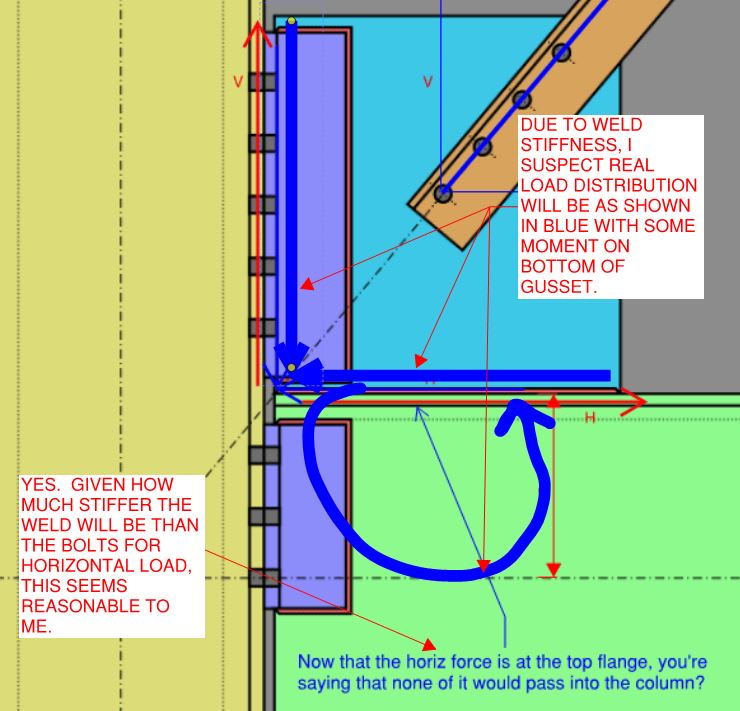

Any chance you've gotten so good at UFM that you now struggle to think in terms of the KISS method that preceded it? I still think that I'm good here but the conversation sort of bifurcates as follows:
1) What are allowable assumptions in connection design? Along with some other assumptions that we don't need to get into here, I believe that I'm allowed to assume any force distribution that satisfies equilibrium. And I believe that my model does that without horizontal brace load being transferred to the column. This is no different than UFM where the assumed distribution is not envisioned to be the "real" force distribution but, rather, a single force distribution of many that satisfies equilibrium and is chose for its calculation expediency and the compactness of the resulting connections. As shown below, I actually feel that my assumed force distribution is fairly consistent with natural stiffness principles which is always a good thing for obvious reasons.
2) What will the real connection stresses be? Who knows. As i said, I feel that my distribution does a pretty good job of reflecting the stiffness of the variable elements. That said, I'm sure that there will be some degree of horizontal force moving from the gusset into the column for any number of reasons:
- No doubt there will be some non-brace induced axial forces moving through the beam/column joint.
- The gravity and eccentric axial loads will rotate the beam end some and, in that sense, impose a moment on the connection to the column plate. And that will express itself as a distribution of flexurally induced horizontal force delivered to the column flange plate. Certainly, if plate welds to the column flange would be fragile with respect to minor horizontal load transfer, that is something that I'd want to address.

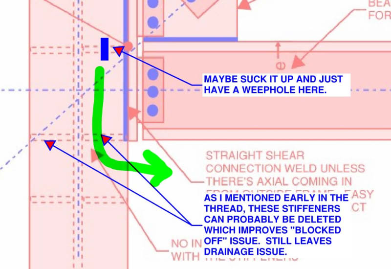

@skeletron: another thought with regard to the "blocked off" business. It really is an interesting point that I'd not considered thoroughly enough initially. You must have some fabricator experience I'm guessing.
No, definitely not that - more like, totally forgot to balance the horizontal brace load with the horizontal load that must be in the beam (i.e., a towards-the-column force). I work in a field of belts and suspenders, so saying to design the beam/shear tab/plate/column load path for shear and tension made sense to me, from a "designing for a worst-case load is faster than trying to prove out a lower load".
At any rate, putting the brace work point on the corner of the gusset certainly makes the connection design more straight forward than the standard UFM approach.

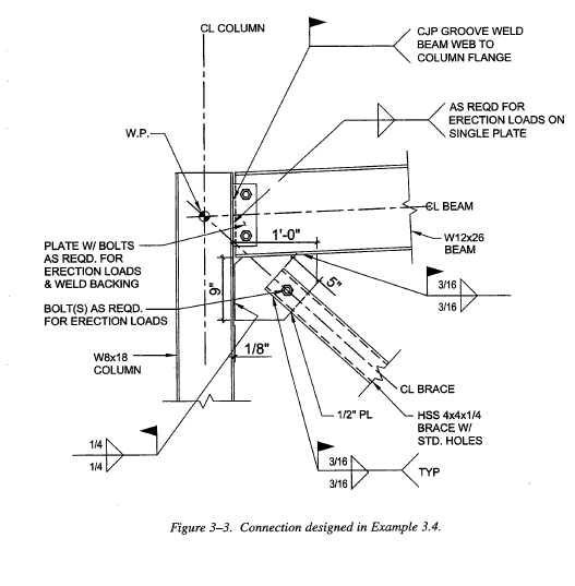

OP. Page 5-49 of the AISC Seismic Design Manual (3rd edition, corresponding to AISC Steel construction manual 15th Edition) contains a step-by-step example you can follow to complete your work. It frames to a column flange, but is similar enough for you to modify as needed. A similar example is given on page 3-25 of the 1st edition, corresponding to AISC SCM 13th Edition.
do you mean this one ?
It's not similar to the connection I'm asking about

If you're looking at the 3rd edition manual, that is on page 3-24. Look at the example on the next page. The brace is different, but the connection concept is the same. Either way, at this point, you have far more than enough information to complete the connection design.

COLUMN BLOCKING
I brought up this because it affects the "finishing" of the column: painting, galvanizing, fireproofing. In each of those three finishing scenarios, I just imagine that the blocking of that small portion of column by the flange plate would increase the complexity of the preparation of the column. You would have to paint the inside of the column before welding the flange plates, which means you would need to tape the weld locations off, move the column to the paint shop, paint it, move the column back to the main shop, attach the flange plates, then bring it back to the paint shop for painting of the flange plate section. Galvanizing would just inconvenience the dippers if that 1/2" hole that you were suggesting, got clogged. And it might be difficult to inspect that inner portion (although it would likely be protected given the mechanics of the galvanizing process). And I'm not sure how you would spray fireproofing in that little blocked off portion. It could potentially be contested as a weakness.
Again...I'm just trying to speculate on what this singular column may have to face. Obviously, there might be situations where the blocking would be okay. It's just food for thought.

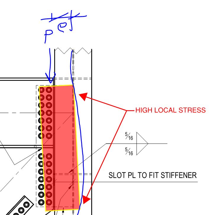

I have a question regarding extended plates,
If I'm a fabricator with connections design scope, EOR is giving me only a criteria for connections design (no Staad.Pro model), in that case who is responsible for checking column for eccentricity moment ?
That's considering I'm sending him my connections report for approval & I don't have sufficient data to check column for additional moment.
