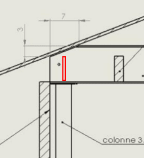

Hello, I have a customer that is asking if it's possible to bevel cut a steel beam in order for them to recess a W8x31 beam into their attic. In my opinion if the cut doesn't go beyond the support width it doesn't weaken the beam in shear nor in bearing. The load on the beam isn't immense, It carries some of the roof and attic load, the steel beam and columns was at the request of the client that works for a steel company.
I just want to make sure that I'm analysing this correctly.
Also, since the top of the beam will be popping into the attic, I will have to ensure top lateral bracing at supports. Do you guys have any efficient way to do this? Is a
The sketches below are written in french (If the name isn't obvious enough I'm from Montreal, Quebec)
Poutre = beam
colonne = column
Solive - Joist
Toit = Roof
Thank you in advance,
1) I agree that this is possible one way or another.
2) I agree that neither shear nor or bearing should be any more critical than they would have been without the bevel cut.
3) I would want a partial height stiffener over the column for added rotational stability, even if it isn't required for web crippling/yielding.

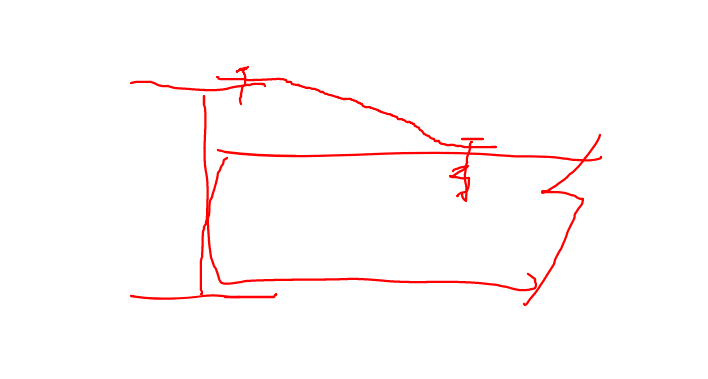

Maybe a bent flat bar every fourth joist? I've seen similar things done with clip angles and shear wall hold down anchors. One tries to avoid interfering with the end slope of the joists but that is not always possible.

I wouldn't trust them to get it tight fitting - at least not tight enough to maintain stability of the beam in a high load circumstance. I prefer discreet connections in these circumstances. One option could be screwing (bolting if the flange is to thick) a nailer to the top flange for a short segment and using a Simpson VB knee brace. It's a modified off the shelf version of KootK's strap.

Thanks to everyone that answered, it helped clarify things alot. I think it will be simpler to have web stiffeners welded since the bevel cut will eliminate the flange at that extremity of the beam making a nailer with braces trickier to do.

I'd check the beam as a coped beam (3" cope, 7" length) to get the approximate capacity at the end. My rough calc is saying something like 40-50% of the non-coped section's shear capacity and dominated by flexural yielding of the web. If you are using steel in a residential context (20ft span, 16ft trib), in the land of 50psf snow load, you might actually come close to this reduced capacity...
I would also ask the fabricator's preference on the bevel cut as shown. There may be complications with getting through the "k" distance at an angle. Strictly speaking, you'd want to radius any corners to prevent stress risers.
Lastly, I would be drawn towards using a horizontal stiffener across the web at the coped section and the vertical stiffener over the column. This is following some of the findings from Cheng's test through the 80s and then the 2001 paper "The Local Web Buckling Strength of Stiffened Coped Steel-I beam".

I disagree. If it makes you feel better, think of it as a short, unbraced cantilever from the first torsional restraint back to the column. Yeah, I'd rather have twist restraint at the support too, just as I would at a cantilever tip. But that is not always necessary and not always practical.

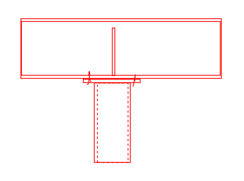

Just to be clear, when I say "partial depth", that does not mean 1/4 depth. Rather, it means pretty much full depth but stopped short to make the fitting of the stiffeners more economical. As far as I know, the connection shown below is quite common for modern Gerber systems where it is deemed to be adequate for rollover concerns. That, or it's two stiffener cousin.
Hmmm... since J10.7 states "At unframed ends of beams...." I had assumed that the whole section was talking about whether that unframed end is (somehow) "otherwise restrained against rotation". KootK, you're reading that say that if the beam is restrained against rotation at any point along the beam about its longitudinal axis, then no stiffeners are needed.
I've never thought of it that way, so bear with me as I poke at this. Say we've got a 20' beam with smaller beams framing in every 2.5' along the entire length, beam ends are unframed and sitting on top of HSS columns. I can see how this situation could meet the intent of J10.7.
What if the same beam/column setup, but a single beam framing in at the center? What if the same setup, but a single beam framing in 2.5' from one end only? Now I'm not so sure.
I'm not saying your wrong, I've just never thought of it this way before.
