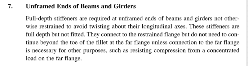

KootK Rewrite said:
Full-depth stiffeners are required at the unframed ends of beams and girders where those beam and girder ends are not otherwise restrained to avoid twisting about their longitudinal axis.
Viewed like that, I think that I'm coming around.
I'm guessing that's from 360-16? I really do need to buy the new book.
It is indeed from 360-16. I gather that some combination of fiscal restraint and morality regarding intellectual property prevents you from having a copy of the new book. Even if you don't have a copy of the good book, surely you've got the commandments which are freely available: Link
I could have sworn there used to be some way to assess these unstiffened ends in the commentary of 360 before but I might be losing it. In any case I think to default to always using stiffeners at unframed ends is overkill, since there is certainly some rotational restraint without them.

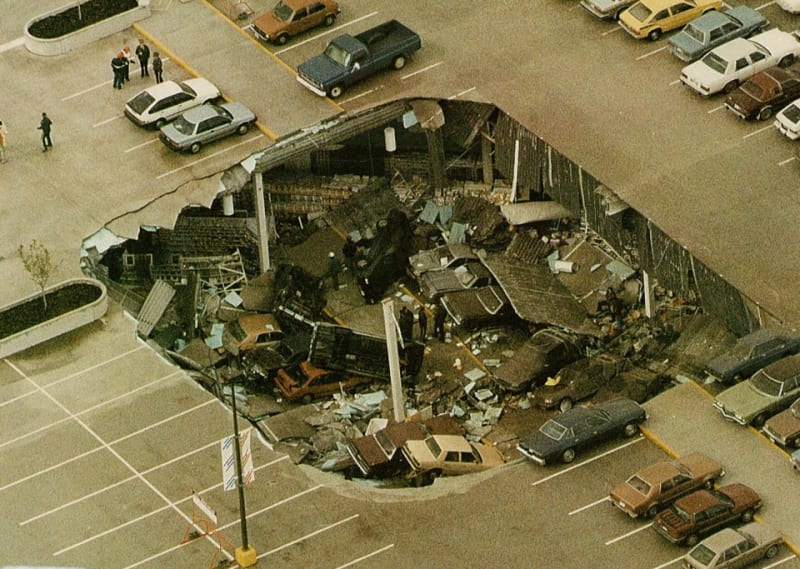

Back to the forensic potential, this collapse in British Columbia was essentially caused by the lack of stiffeners over a column facilitating a side-sway buckling failure in a OWSJ system. I'm certainly in favor of including stiffeners which would serve as cheap insurance in the many situations in which it makes sense to do so. While I do believe that one can calc their way out of stiffeners in many cases, I also feel that it's usually not worth the trouble / uncertainty design side.
KootK, if that is the case (that you can check assess the unstiffened end via J10.4), why not just write J10.7 to say
"At the unframed end of beams, check sidesway web buckling. Use full web-depth stiffeners if req'd."
I'm not saying you're wrong, just that it seems odd to include J10.7 if you can just check the end using J10.4.
I see your point, of course. However, in my travels, I've encountered several instances in which codes / standard provisions have been ambiguous and/or poorly coordinated internally. Heck, I remember an issue coming up here once where we reached out to AISC and it turned out that AISC itself didn't really understand the origins of a provision because the one guy that spearheaded it had died. Seriously. Here, I'm not even sure that I agree with your guys' interpretations of "unframed" or "restrained against twisting about a longitudinal axis". You've shifted my needle some but, with that kind of uncertainty in play, I'm hesitant to read too much into semantics.
I've got to dig through my miscellaneous papers and track down the partial insurance investigation file I have that relates to some of this. I have a connection to an engineer who worked on that side of things and I ended up with it at one point. It's been so long since I looked at it, that I don't even remember if there was anything interesting in it.
