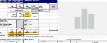

This is from "Reinforced concrete design to eurocodes" by prab bhat, page 371 and 372.
It has mentioned the it's for My/ (hb^2) = 2.
But I don't know how to reproduce with that ratio kept constant. So, I tried to create it with making the alpha and beta values at a constant ratio of 0.8 (beta = 0.8 alpha). Then I produced a chart.
Since I didn't reproduce the exact chart in the book, now I have another problem. I have got no reference chart to compare my chart with. Can anyone kindly help me find out if my chart is correct for the column dimensions and data I provided.
Are there any free software/ excel sheet to enter the column details mentioned below and compare it with my chart?
I'm concerned that my chart may not be correct as I don't see the part the book's chart have I have shown in the green rectangle below, when I produce my chart. I understand it cannot be the same chart, but if my chart is correct that "nose" like curve should also be in my chart isn't it.
1. Chart from the book
2. The chart I produced

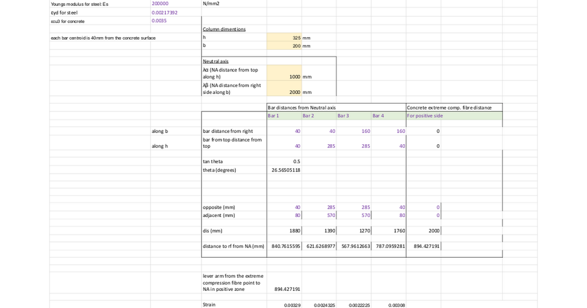

This is a rectangular column, h = 2000 mm, b = 1000 mm. I maintained "beta/ alpha ratio = 0.8".
4 reinforcement bars, 1 bar each corner. Steel percentage 4% (So, 1% bh area for each bar).
40 mm distance from column surface to the centroid of r/f for each bar.
fck = 30 MPa, fcd = 20 MPa, fyk = 500 MPa, fyd = 434.7 MPa.

Have another look at Fig. 6.1 in the code:
- When the bottom face is in tension the top face strain stays constant at 0.0035
- When the NA reaches the bottom face the top face strain is still 0.0035, the bottom face is zero, and point C is 0.00175 (or 0.002 for the parabolic stress block).
- For any further increase in axial load the strain at C stays constant, the top face strain gradually reduces and the bottom face strain continues to increase.
- Under uniform compression the strain across the full section is constant at 0.00175 or 0.002.
- There is never a step change in the strain at any point, so there is never a step change in the moment capacity.

Yes, the strains are just for the calculation of the steel stresses. The stress for the rectangular stress block is defined in the code, and it doesn't say anywhere it should be reduced for sections with uniform compression.
The code also does not say there should be a jump in the strain at any stage. It says that plane sections remain plane, which means the strain will always be a straight line from the Neutral Axis to the compression face. That means the strain at the top face transitions smoothly from 0.0035 when the NA is at the bottom face to 0.00175 when the NA is at infinity. Over that range, the strain at C remains constant at 0.00175, and the strain at the bottom face increases from 0 to 0.00175.

Full calculation? Sure:
Force = Concrete stress x concrete area + (Es x 0.00175 - concrete stress) x steel area.
All forces are symmetrical about the concrete centroid, so moment = 0.

Yes, why do you think you need to do anything else? The whole section has the same strain and stress, so just multiply by the areas to get the force.

No, we aren't over-estimating the in-between points. The curve if you did the calculation would be slightly convex, so a straight line would be slightly conservative, but the difference is very small.
You only get the step in the line in your graph because you insist on reducing the strain at the compression face down to 0.00175 as soon as the NA is outside the section,
but the code doesn't say you should do that. For instance, if the NA was 250 mm below the bottom face, with a 500 mm deep section, the strains would be:
