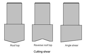

Hey guys! I hope you're doing well!
I need to build a device that makes a circular cut in a single hit on a steel plate, using a pneumatic cylinder. For this, I need to estimate the force that the cylinder needs to make the cut, as shown below.
The diameter to be cut is around 100 mm.
The compressed air line pressure is 6 bar.
The thickness of the AISI 1020 to be cut is 0.5 mm.
What intrigues me in this case is how to consider the contact area between the blade and the plate, since I intend to manufacture something like the image below.
Why do I want to use this geometry? I strongly believe that the cutting force vs cost ratio is more advantageous, precisely because of the area.
My plan is to estimate the shear force, and then with the air pressure used in the cylinder find a cross-sectional area to select the proper cylinder, assuming a 15% "safety factor" for the cylinder.
Are there any tips or tricks for considering the area of this slide and find an analytical solution?
Thanks in advance for the support, guys!

That's going to be rough to manage - the tapered cutting edges will force the small diameter dimension of the cutter in the surrounding material to expand to the large diameter of the cutter. Without a stripper mechanism that surrounding material will be tightly sprung around the cutter.
Typical punches don't have that diameter change so they don't require so much force.
Even at 0.5mm I would not expect a pneumatic system to be a good choice unless it is used to raise a drop-hammer.

Blanking Force = Perimeter of the Cut × Plate Thickness × Shear Strength
with the inclusion of "shear" on your punch, you could derate the blankiing force - a conservative estimation would be to use the formula above.
A reasonable value for shear strength for steel would be 75% of tensile strength (not yield).

Many Manufacturing Processes course textbooks that have chapters on sheet metalworking will give an equation very similar to dvd's:
F = 0.7 x T x L x (UTS)
T = thickness of material
L = total length of the sheared cut(s) performed in the single pass of the press
UTS = Ultimate Tensile Strength of the material
or, if you have data on Shear Strength, then it becomes F = T L (SS)

The shear length will be .5mm*cos(blade angle)*number of blades*2 (number of edges per blade). Obviously the limit is the cutter perimeter length with a single circular blade - cookie cutter style.
There is also bending of the can rim on the outside of the cutter because of the blade geometry. This will guarantee clearance for the magnetic lid lifter.
Your design ostensibly requires 6 times the force of a normal can opener initiation, since there's usually only one blade, instead of six. Unless you have ultrafast stopping control, you're likely going to slam the cutter into the soup can
