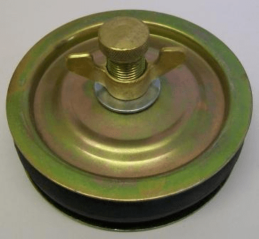

Only other thing is to insert an expanding plug into the nozzle as your primary seal and then add this blind as a secondary containment and paint it yellow to warn everyone.

I can't put anything inside the vessel, the only thing that I could do is acting on the blind from outside (e.g. welding sort of reinforcement to the outside face of blind...? Or clamping in a certain way?)

LittleInch said:
Not even something like this??
What is the name of that "plug"?...but it will take too much time to find it on the market.
Plumbers use them all the time.
6 inch plug (you get some err interesting options with that search) or "expanding pipe stopper"
