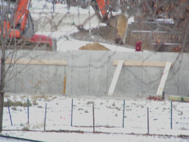

Here is a job in my neighborhood, next block north. The contractor is an experienced guy and the availability of excavators, concrete, etc has put him into winter. Today he is placing sand fill between a filled driveway area and the wall, now about 10 days old My hand held camera set at its zoom from my living room does not do the best, but here is the picture. Let's hope that filling doesn't overload the green concrete. Some tree branches in the way also.
That looks like the situation in which my neighbor's foundation cracked.

Just finished my walk and stopped to see the builder. Says he is waiting on Menards for the lumber (big question) so is biding time. The walls are 7-1/2" thick with some (didn't say how many) horizontal bars. Didn't seem worried, but says many have questioned what is there. Using sand backfill. Could be frozen and not noticed due to very small water content. So with warmer weather predicted, let's see what happens. I'm surprised the local code does not require thicker walls. One large jog in the one main wall may be the saving thing.

Those are some sketchy braces if they are just toe-nailed into the nailer. I get to look at a few of these that have fallen down but there must be hundreds that escape damage or aren't known if there are no casualties.

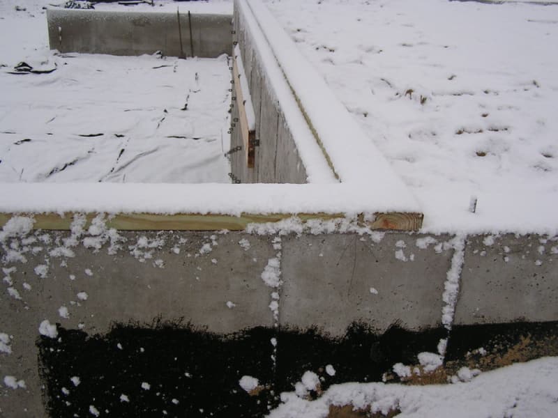

For what it is worth today Dec 10th. Contractor just filled the garage area. The earlier pix was before any filling there. I have some clear shots of that now and will keep an eye on it from my easy chair a block away. Full height of garage a reasonably clean sand just dumped in. Temp below freezing still. Sand likely fresh from pit, probably not frozen.
Edit: While typing I now see they removed those braces and are grading lower floor area out if front of wall. Wow.
Dec 12th situation. Wall backfilled a few days back. Still holding.
Garage is to the right in photo. Hopefully this not a "before" shot.
My guess is than an engineer will be coming back to the site to address the settled garage slab at some point.
Agreed, especially when the owner uses sand "because it doesn't settle"?? Notice the foot prints before it snowed. Also, those 2 bys somewhat attached maybe the "straws that hold it".
