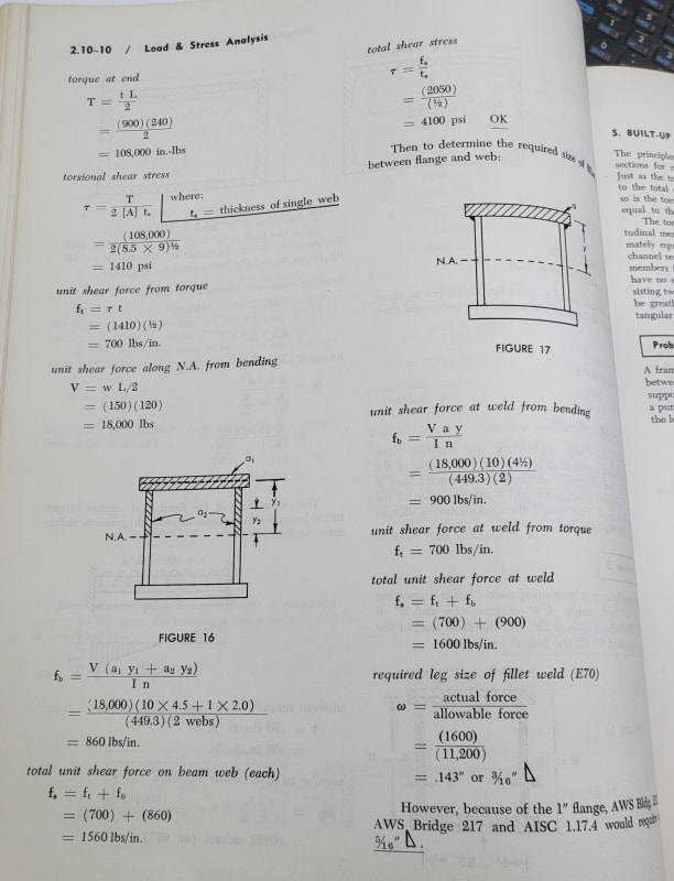

Hey all, first time poster, long time reader here. I was taking a spin back through Blodgett's Design of Welded Structures recently and was reviewing the section on torsion. Problem 5 lost me on 2.10-10 calculating the total shear stress on the built-up section, hoping one of you can help clarify/confirm since there doesn't seem to be any errata published. Maybe it's just too early and I haven't had my morning coffee yet.
Starting with unit shear force along the N.A., the first moment of area for the BU box webs is calculated as 1in2 x 2in, but seems like it should instead be 4in2 x 2in, resulting in fb=1060 lbs/in. This would give a total unit shear force of fs=700 + 1060 = 1760 lbs/in and a total shear stress of Tau=1760/0.5 or 3520 psi compared to Blodgett's value of 4100 psi.
What am I missing here? Even if Blodgett's numbers are correct, I'm not clear where he jumps from a total unit shear force of fs=1560 lbs/in to suddenly using fs=2050 in calculating total shear stress. Any clarity would be greatly appreciated.
You don't mention which edition you are using. I have the eighth printing, dated July, 1976. Here is the problem from that edition.
Thanks for the picture SE, I have the same edition. My first point of confusion is the bottom left of the picture, in the calculation of fb, where I believe the value of a2 should be 4in2 based on figure 15 from the previous page.
My second point of confusion is in the subsequent calculations, where fs is calculated to be 1560 lbs/in. This value then changes unexplainably in the calculation of total shear stress (upper right of your picture) to 2050 lbs/in. I'm hoping someone can help me either make sense of that disconnect or confirm my numbers in the original post are correct.
Regarding a2, I agree.
I don't know where the 2050 comes from. Sorry. It would seem to me that t = 1601/0.5 = 3202 psi.
