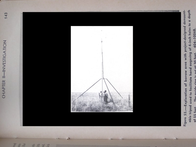

Here goes OG with a photo from US Bureau of Reclamation manual 1963. Hand auger borings to 55 feet. guide ring set at 30 feet in borrow area, 4" diam samples.
Nice tripod! Ours wasn't that cool! Had to use forked branches of a large oak tree to stack rod on one job! Ours was more like what f-d described....cathead on a Briggs and Stratton with donut hammer.
