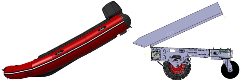

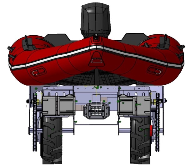

Hi I am installing these motors to the backside of my boat for propulsion and also for steering using dual motor controller.
My boat is this.
The steering mechanism is like this.
The motors are all fixed on my boat and I want to steer the boat by proportionally controlling each motors rotation.
Is this feasible in reality or should I just go for normal outboard steering mechanism which is just rotating the whole outboard?

That is a folding boat. The motor transom was design to react the forces from the motor. Are you going to mount the motors on reinforcement? This propulsion seems ill-advised based on your craft.
20KW to propel a boat like that is asking for trouble.
It's entirely possible to control the orientation of the motors with proportional control, but the power will likely damage or destroy the boat.
I looked up those boats and they are rather neat, but inherently flexible. The vendor says they flex up to 12% when they hit a wave....
There is no way they can take motor force other than directly in the centre and I don't think they could handle more than about 5 to 7 Hp, so 5kW max.

What is wrong with using the extremely flexible inflatables instead of that folding boat?
If you were going into production with some sort of autonomous lifeboat, you might think about using expanded polystyrene shaped like an oversized lifesaving torpedo. It would be a (possibly recyclable) short-lived unit.

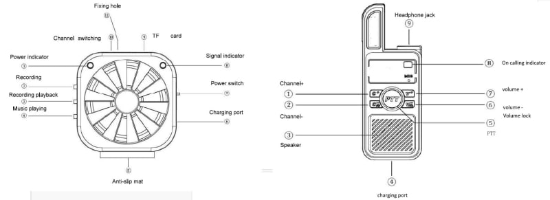

I have been thinking about this for a while and the only solution for this is putting indications on the boat and also use this drone speaker so that the operator could tell the passengers not to come closer to the back side of the boat when the boat is operating. Or I just put waki taki or something.
Using inflatable boat is fine with me. I was just worried that it might be punctured by some sharp edges but I guess the material is tough enough these days. I will check it.
Putting the propellers in nozzles eliminates prop walk which will simplify your steering. It can also make the system more efficient at low speeds.
Operating in floodwaters makes me think that you need to be prepared to hit stuff that's hidden underwater, doubly so if you don't intend to have a human on board. Tug's prop nozzle idea would help keep the props from being damaged, but you still risk damaging the motor itself if you hit something hard enough. That makes me think about jet based propulsion (like a jetski), but maybe there's other issues there too. Have you contacted anyone who actually does these types of rescues to see what works and what doesn't?
