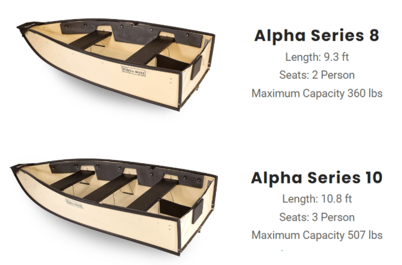

Hi I am installing these motors to the backside of my boat for propulsion and also for steering using dual motor controller.
My boat is this.
The steering mechanism is like this.
The motors are all fixed on my boat and I want to steer the boat by proportionally controlling each motors rotation.
Is this feasible in reality or should I just go for normal outboard steering mechanism which is just rotating the whole outboard?
The motor is very strong. 10kW. Strong enough for decent propulsion for my boat.
but, I am not sure whether this concept is good for steering.
That is a folding boat. The motor transom was design to react the forces from the motor. Are you going to mount the motors on reinforcement? This propulsion seems ill-advised based on your craft.
20KW to propel a boat like that is asking for trouble.
It's entirely possible to control the orientation of the motors with proportional control, but the power will likely damage or destroy the boat.
I looked up those boats and they are rather neat, but inherently flexible. The vendor says they flex up to 12% when they hit a wave....
There is no way they can take motor force other than directly in the centre and I don't think they could handle more than about 5 to 7 Hp, so 5kW max.
Steering using differential thrust is possible, but normally very difficult to keep a straight-line or make small adjustments for wind or to make a gentle curve. Great for doing doughnuts in the middle of the lake, but otherwise not much use for anything else.
But fit those to that boat and I don't think the craft would make it to the other side of the lake.
Take a life jacket, some flares and a waterproof radio for when the boat breaks up mid crossing.
We had a fibreglass dinghy about that size and a 2hp yamaha outboard and even that flexed the rear transom. I would say 5hp absolute max in the centre only.

That looks like a very small propeller for 20hp. I wonder about the weight of the battery ?
I'd've thought a rheostat would be able to control both motors? But you can tell it is designed for one motor on the CL. If you insist, I'd mount the two motors onto a board that I'd attach to the central "handpoint".

Yes, you can steer a boat this way. We call it twin screwing in the tugboat world. It can get you home after a steering rudder failure but that is all. Maybe it would be more feasible with electric due to faster thrust reversal.

Hi thank you so much for your answers.
No, I am not dead yet cause I haven't tried a test yet.
So, it seems that the design would be feasible for propulsion and steering if I reinforce the boat structure properly.

This is a folding boat. You won't find it easy to " reinforce".
I don't think this is really feasible Why do you do?
I see, then could you recommend me some other boat that is feasible for this project?
My plan is to develop some RC boat for rescue activity that human can ride or hang on to.

Maybe it is your intention to install the motor/prop in a shroud or tube, but that spinning prop would cause some real damage to some poor soul being rescued remotely in rough water.
What is wrong with using the extremely flexible inflatables instead of that folding boat?
If you were going into production with some sort of autonomous lifeboat, you might think about using expanded polystyrene shaped like an oversized lifesaving torpedo. It would be a (possibly recyclable) short-lived unit.

Putting the propellers in nozzles eliminates prop walk which will simplify your steering. It can also make the system more efficient at low speeds.
Operating in floodwaters makes me think that you need to be prepared to hit stuff that's hidden underwater, doubly so if you don't intend to have a human on board. Tug's prop nozzle idea would help keep the props from being damaged, but you still risk damaging the motor itself if you hit something hard enough. That makes me think about jet based propulsion (like a jetski), but maybe there's other issues there too. Have you contacted anyone who actually does these types of rescues to see what works and what doesn't?
