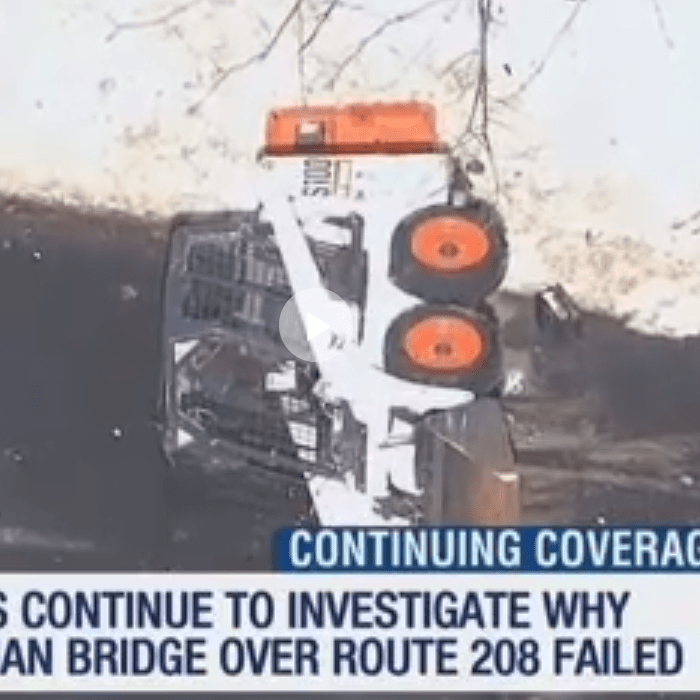

Bobcat punches through ped overpass deck, lands on van 1

Apparently it wasn't designed for vehicle loads. I thought it was common practice to design them for H-10 loads for maintenance vehicles and ambulances.

BrianPeterson, you're probably right, and it was a good idea. The failure to check whether the bridge could support the loading of the Bobcat is where they obviously went wrong. Just because the bridge will support 75psf over most or all of its length, doesn't mean it can support a 1200 to 1500 lb point load (rear wheel).

The video in the original post appears to show S100.
I couldn't find it on the US site but the EU site says it is either 1,860kg or 2,149kg depending on HD or Solid tires (tyres).
So between 4,100 lbs and 4,739 lbs.
In the article posted by ACtrafficengr it can be seen this pedestrian footbridge remain structurally sound as its main members are substantial steel girders spanning over the highway below. The failed portion is a lightly reinforced concrete slab, possibly spanning between the main steel girders, visually showed to be between 2.5" to 3". Since the Bobcat fell somewhere near the mid span I wonder how many of us would walk to the hole to inspect the damage and ignore the fact part of the deck is likely has been overloaded by the previous Bobcat and could collapse at any time.
There is a year (1959) stamped on the bridge abutment which has some corrosion problem exposing some of its vertical reinforcing steel. If the stamped year is correct, which to me looks about right by the design and the extent of the concrete corrosion of the bridge, the structure is 60 years old!
The bridge deck is of reinforced concrete construction. In Civil engineering installations reinforced concrete typically has a design life 30 to 50 years. One needs to go to a nuclear power station to find concrete designed to 80 to 100 years life. After the design life lapses the concrete is expected to be well carbonated, unable to protect the embedded reinforcement which would corrode away. Once the reinforcement has been compromised the structural integrity of the bridge is gone. Anybody driving a Bobcat over it is asking for trouble.

In order for this bridge to have been adequate for the Bobcat, likely the only change needed would have been more substantial reinforcement and possibly a slightly thicker deck. If it required a thicker deck, it might have needed slightly larger girders (heavier or deeper) as well. While it would represent a modest increase in cost, it presumably would be going beyond the design requirements for a bridge too narrow to fit a road vehicle on. If the 1959 date saikee119 posted represents the timeframe in which it was built (very likely), equipment like the Bobcat didn't exist, so it would have not been an anticipated loading. This was not a design failure. "What we've got here is failure to communicate." That, or a failure to heed the limitations that were communicated.
What should have happened when equipment like the Bobcat were starting to be used for snow removal by the city, is the bridge should have been evaluated. When it was found inadequate for wheeled vehicles, bollards should have been installed at the ends of the bridge, so that the Bobcat could not get on it.
If saikee199 is correct with the 1959 construction date then that explains why no one would have anticipated a Bobcat or similar small vehicle on the bridge and designed and/or limited access accordingly. A quick internet check finds that the Bobcat originated as a farm implement in 1958.
In the late 1950's, the only four wheel vehicles that might have access to a pedestrian bridge like that would have been a Cushman, and a quick check shows they weighed around 350 lbs max plus occupant(s), and would have had a sight more spread-out wheelbase than the pictured Bobcat.

If the operator did a neutral steer, for whatever reason, then the stresses would be locally increased for a short time with torsional as well as gravity shear forces.
