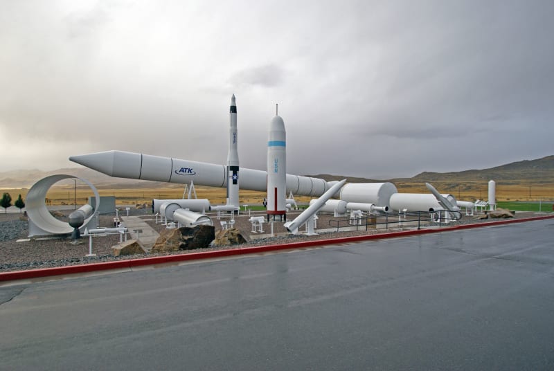

On one of our 'photo safaris', my friend Dennis and I stopped at the ATK testing facility near Promontory, Utah. They had what they called a 'Rocket Park' (we saw it on one of those 'brown signs' you see along the interstate), outside their fenced-in secure area where anyone could stop and look at examples of their rockets, which included things like the Minuteman Missile and the shuttle booster, as well as some smaller and experimental rockets:
October 2009 (Sony A100, 10-24mm)

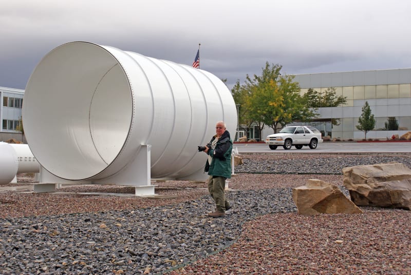

Now being a couple if engineers, we immediately went and looked at the shuttle booster. And while there was never any mention in any of the placards about the Challenger accident, they didn't try to hid anything either. In fact, they had on display a section of the booster housing, which would have been very close to where the failure occurred, where you could clearly see the O-Ring grooves.
Here's a shot of that section of the booster:

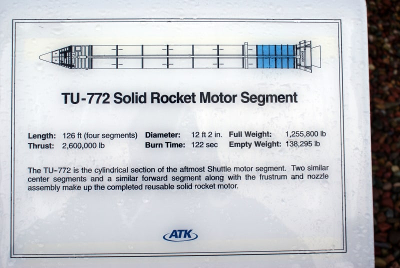

And of the placard describing where this section was in the booster assembly:

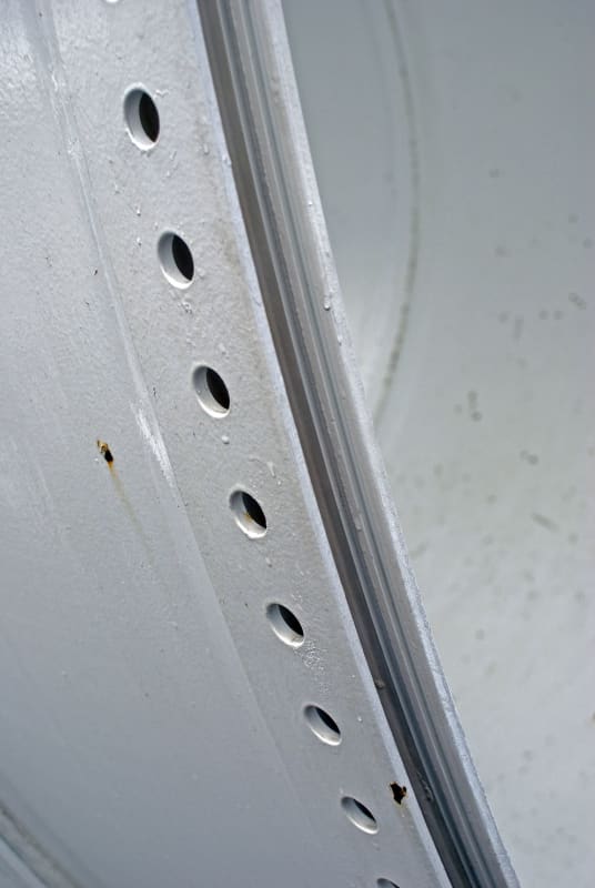

And here's a close-up of the O-Ring groves:
