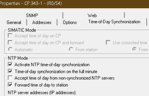

You need something that can distribute the time signal, generally IRIG-B. Even without a reference clock every thing on site would at least have the same time. You can’t manually set device clocks accurately enough for things to align. Manual time alignment post event can be easy or it can be a true pain. Getting relative time right is a huge step, getting absolute time correct is a nice addition if you’re dealing with a single site. With multiple sites about the only way to get relative time right is to have absolute time right.
Had one event 5 years ago where it took days to align multiple event records that claimed to span 2 years into the actual span of less than 5 seconds. Part of it was there two very similar faults in the overall event; had to figure out which relay was seeing which fault at what point in the sequence. The newer event viewing software (example shown above) certainly makes it easier than it used to be.
All Siemens CPU:s can be set with a time sync via CP434 CP334 if they are connected to the ethernet.
And if you have a server with clock sync avalibul, like Network Time Protocol (NTP) the same as for the computer.
Then at least all "Siemens" data will have the same time.
If it is possible with the SEL 387 relay I do not know, maybe that one will have to be set manually.
