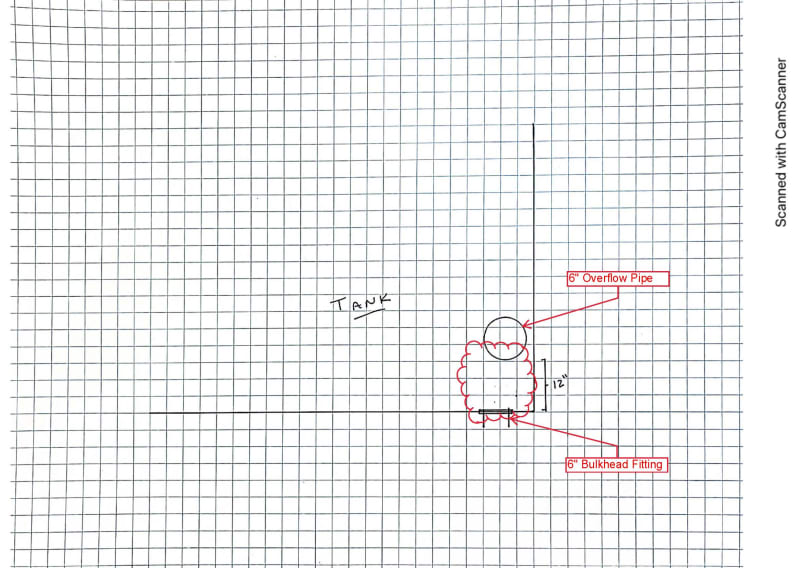

Thank you both LittleInch and shvet for your quick responses. You're right, I should have provided more details. Here is a sketch of my problem. I need to install a vortex breaker on the inside SIDE of a tank that I have limited access to. In addition there is a pipe, located 12" from the vortex breaker area so I have limited space in front. The tank fitting is intended to be a bulkhead fitting so to avoid welding. See attached sketch for general area.
What could I install in that small area that acts as a vortex breaker for the outlet on the sidewall?
I am working to become better at my drawing skills, I am using them more and more these days. Thanks for your help.
-Mark
Plan view or side view?
Do you have access to the other part of the pipe or can you cut it to get access from the outside?
What is the elevation level wrt to pipe entry into the tank and liquid level?

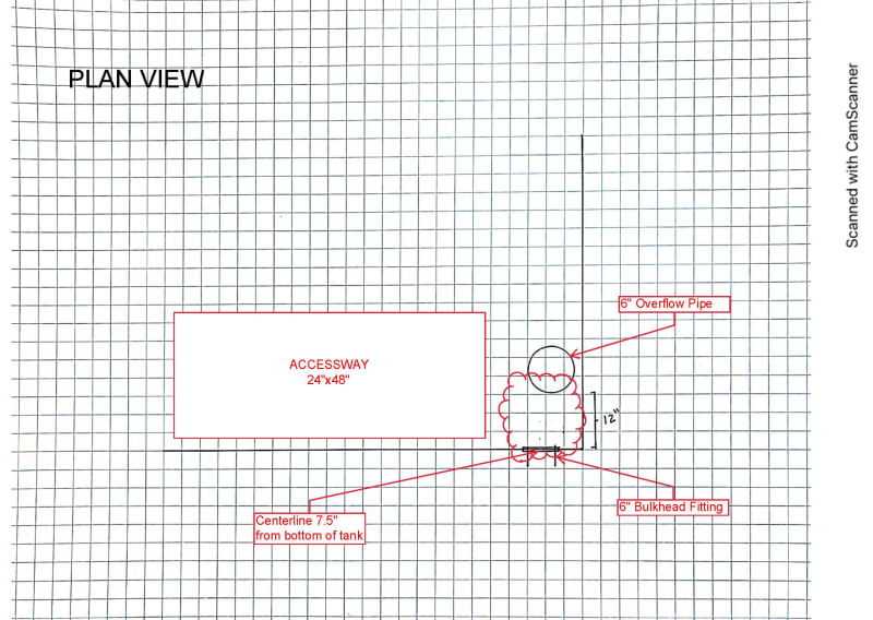

LittleInch, thank you for your response. I have updated the drawing to show the access to the tank and the height of the centerline of vortex breaker location.
It is unknown right now the exact water level above the proposed 6" outlet, but let's assume the water level is 24" above the top of the outlet.
See bottom right corner of below image for location of vortex breaker associated with drawing above.
We are putting an outlet on the bottom side of the bottom right corner and have a downpipe in the immediate area minimizing space. If we were to weld on a vortex breaker, would you recommend a flat plate or a cupped plate? Do we also add a cross in the outlet or is the plate sufficient?
-Mark
Any welding supervisor in the shop will give you, in 3 minutes, the practical solution without a drawing.
Regards
The question is, why do you need a vortex breaker?
At worst I would just add a 6 x 10 reduced, as long a bit of 10" pipe as would fit with a cap on the end then cut out the lower half of the 10" pipe. Or if that won't fit then a 6" pipe with the lower half cut out and an end cap. Or cut slots. So many ways to get it to fit in. Or a 90 elbow and do the same thing.
You can stick in a an internal cross to stop fluid swirling in the inlet.
But what sort of velocity have you got int he 6" pipe?
