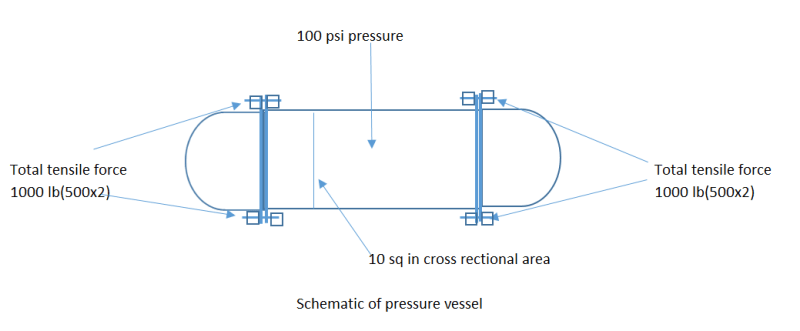

I have a question, now let's say I have a pressure vessel that is cylindrical and has two caps on both ends. To make it simple, we only need one nut and bolt for each side. So let's say the force is 1000lbs. So I will find one nut and bolt that will handle 1000lbs on one end of the cap and one nut and bolt that can handle the other end of the cap. Simple. But now let's say if I had a long threaded bolt that will go through both cap, so now I only need one nut and bolt that will go through both caps. Is my force still 1000lbs or is it 2000lbs because there's 1000lbs of force on each side of both caps? So I need to find a bolt that will handle 2000lbs of force? How can the pressure stay the same, yet the force doubled? Or is the force distributed so it's only 1000lbs still?

Draw a free body diagram of just the cap for the case with bolts. Pressure x internal area is resisted by the total bolt tension. Now do the same for the case with studs. It's the same diagram. Whether the bolt tension ends up being applied to the back face of the mating flanges (in the case of 2 sets of machine bolts) or straight through to the nut on the other cap (long studs), the bolt tension is the same for both arrangements.
GBTorpenhow is correct!
I elaborate the concept below:
If this is your concept,
Then the tensile force across through bolt remains same (1000 lbs)as below

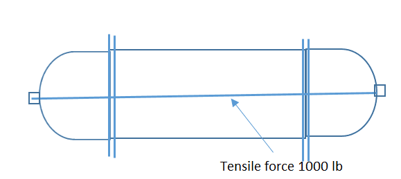

I would thought the force exerted on each side of the flange is 1000lbs, so if both side is pushing 1000lbs, the total has to be 2000lbs of force exerted. So I need to size a bolt that can handle more stress, ie. a higher grade bolt. I understand the stress on the flange wouldn't change, nor anything else about the system.
Here's what I meant by through bolts. I simplified the idea just by using one bolt, so I revised your drawing slightly to go with your diagrams, here's what I meant.

The tension on your theoretical bolt is 1000 lb. The pressure does not 'double'.

Say you attach a rope to a wall on one end and you pull on the loose end with a 1000 pound force. In this case the force in the rope is 1000 pounds. correct? Now instead of attaching the rope to the wall you give it to someone to hold. Now you pull with a 1000 pound force. In order to balance the 1000 pound force you are exerting the other person also needs to pull with a 1000 pound force on the rope but in the opposite direction. correct?
In both cases there is only 1000 pound tensile force in the rope. In the first case the wall provided the opposing force and in the second case the other person provided the opposing force so that in both cases the sum of forces equal zero and no acceleration occured. The force in tensile force of 1000 pounds that was imposed by the person puling was either resisted by the wall or by the other person but still the tensile force in the rope was 1000 pounds.
Another way of stating it is that if you take a cut on the crossection of the rope at any point and if there is static equillibrium there is a 1000 pound force acting in one direction and 1000 pound force acting the the opposite direction on the crossectional area and there is 1000 pounds of tension produced in the rope.
So now take your pressure vessel. You cut the vessel in half and weld the cut end to a steel wall around the entire circumference. You pressurized the vessel to a point where the pressure produces a 1000 pound force internally on the head side acting away from the wall. This 1000 pound force is transfered through the vessel wall, through the weld and then into the supporting wall. On the other side at the wall the pressure force is transferred directly into the wall without going through any part of the vessel. So the tensile force in the vessel wall is 1000 pounds which produses a tensile stress of 1000 pounds divided by the area.
Now remove vessel from wall and reattach the other half by welding the circumferential cut point and pressurize so that there is a 1000 pound force acting on the same end head that was not attached to the wall before. In this case there must be same 1000 force acting on the other end head of the reattached side which balances the other end 1000 pound force thorugh tension in the shell wall.
In any case the net tensile force is only 1000 pounds in the vessel wall.
Thanks all! It's just weird thinking that instead of using 4 bolts, that you can use 2 bolts and still have the same force on the bolts.
