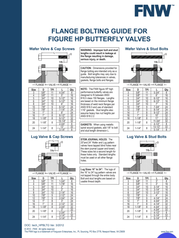

I am looking to install a lugged butterfly valve with a 316SS body. I'm trying to decide if I should use B7 or B8 (class 2) Hex bolts for this application. The flanges are also 316SS. My concerns with using B8 bolts are the lower strength, and the risk of galling (even if using a anti-seize). They're also not cheap. My concern with using B7 bolts is the risk of galvanic corrosion occurring between the valve body and bolts, since there will be direct contact at the threads.
Does anyone have any experience with stainless lugged body valves? Do you think I'd be fine using B7 bolts if we use a lubricant?
Any input would be greatly appreciated.
Thanks.
For tapped holes, use hex cap screws, not hex bolts.
I would not use B7 with a stainless valve/flange for galvanic corrosion reasons. Differential thermal expansion could possibly be an issue as well depending on the joint geometry and temperatures expected.
Yes, B8 or B8M Class 2 cap screws are expensive. Depending on your valve size, pressure class, thread engagement, and gasket stress requirements you might be ok with Class 1 screws.

For tapped holes, use STUDS, not hex bolts.

You can go either way. Studs can be easily cut and renewed if a nut seizes.
