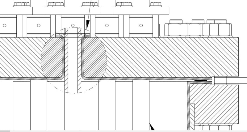

Hello all,
I want to discuss regarding the design of blind flange with multiple opening on it. I have designed the blind flange as per ASME SEC VIII div I Appendix-2 and for multiple opening, I have also verified the flange as per UG-39(d)(2) and (e)(1).
Flange OD = 1100mm
Flange Thk. = 80mm
The blind flange has Dia.45mm 24 Nos. openings and 5Nos. Nozzles are mounting on it. Refer below sketch for your reference. Nozzle N1,N3,N2,N4 are 2"NPS and Nozzle N11 is 3" NPS. Refer below drawing.
Please provide your suggestion on this.
Thanks & Regards,
Vishal Mistry

Are the green circles through thickness openings in the blind, with no nozzle, 24 in total? What are the openings for?

The blind flange has 24 Nos. x dia.45 hole on it. Which is shown in the drawing with green color and 5 nozzles are mounting on it which is mentioned in my first post.
I still dont seem to understand (and may be the only one) what the green holes are for. What is mounted on or to them, when you also have noles with nozzles? Or are the holes female threaded in some way? Or will a pipe be inserted and welded to the flange? Not sure how youre hoing the create a differential pressure ..

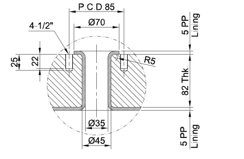

the candles are mounted through this holes. Pressure is not acting inside the hole. Refer below section sketch for the hole.
I hope now this is clear.

Perhaps ASME VIII-1 Appendix 41 might provide some further guidance with respect to the multiple penetrations without consideration of any "nozzle neck".
Spot on Tom, App 41 is an appendix often forgotten while it provides great use for certain designs. However, I never have found a section in App 41 saying whether the heating elements may be (aprtially) hollow. Section 41-6(a) seems to implicitly say that it does not affect the design or calculation.
I believe appendix 41 (formerly a code case) is only really applicable to EIH support plates, and this design with the additional nozzles around the outside doesn't meet the conditions of applicability either.
Unlike a tubesheet with some possible level of tube joint enhancement, the ligament efficiency in the EIH support plate calculation does not allow for any contribution of the tube wall, therefore it doesn't matter if the heating element was solid or hollow.
