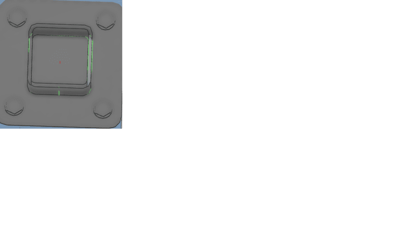

Hey
I have a bolted endplate with a connected SHS to it, and I want to find the total tensile force on this plate. The obvious one is the applied Fz component, but I guess I need to consider the tensile force from Mx and My as well (see attached picture). Can you give me some tips on how to find the total tensile force?

If the HSS has a tension of Fz, tension on each bolt would be Fz/4, for a total of Fz for 4 bolts and zero for the plate.
Mx would add a tension of Mx/d1 to 2 bolts and a compression of Mx/d1 to the plate.
My would add a tension of My/d2 to 2 bolts and a compression of My/d2 to the plate.
d1 and d2 are the effective depth in the x and y direction respectively. d1 is about 0.9(h-e). d2 is about 0.9(w-e).
So the total compression force felt by the plate would be Mx/d1+My/d2. The plate would feel no tension force because tension is always carried by anchor bolts.

Sorry, the explanation was sparse for this problem. The thing is I'm making a program that checks bolted connections with end plates like in the picture with SHS beams connected to them. Users can input Fx, Fy, Fz, Mx, My and Mz (according to the axis in the picture) together with dimensions for the endplate and the SHS. I've programmed all checks for the bolts, so now I'm programming the checks for the endplate.
I've found the design tension resistance according to EC3 1-8 table 6.2, but I was unsure what the actual tensile forces on the plates were given the parameters mentioned above.

Maybe it didn't come through earlier, but the HSS is connected at the centerpoint like this.

No, that would be wrong. There are several tensile forces acting on the plate. Any one of these can produce bending moment and shear on the plate.
But here is what you said in your original post:
If the plate is in equilibrium, the total force and total moment on the plate in any direction is zero.
Fz is the axial force delivered by the HSS. If it is downward, anchor bolts are not involved because the plate simply bears against the substrate, which acts upward. Together, they cause moments in the plate, but the resultant upward force on the plate is zero.
If Fz is upward, the HSS is in tension and Fz is resisted by four anchor bolts, which cause moments and shear in the plate, but again, the total tensile force on the plate is zero.
Moment Mx produces tension 'T' on two anchor bolts and compression 'C' on the opposite edge of the plate. We know that T = C and Mx = T/d (or C/d) where d is the effective distance between T and C. T acts at the center of bolts, but the precise position of C is not known. If we assume that d = 0.9(H-E), then the two anchor bolts create a moment about the face of the HSS tending to bend the plate down. On the opposite edge, force C tends to push the plate up.
A similar argument can be made for My. Plate moments for Fz, Mx and My can then be determined, approximately by adding the three effects together algebraically.

To me it seems like number 6 is the case that fits our scenario.
If leveling nuts are used under the base-plate, anchor bolts can take compression as well as tension. In that case, why not consider the area and moment of inertia of the bolt group, then calculate the force in each bolt? From that information, calculate the maximum base-plate moment required.
If leveling nuts are not used, the above method should provide a conservative estimate of the required base-plate moment.

Not quite sure what you mean by your last question, but if the HSS is a small profile compared to the plate height and width this could be critical?
you ask about "total load on the plate". a moment does not change the total load. BA suggests maybe looking at the load on 1/2 the plate, to capture the couple ... but that's not your "total load".
yes, of course the HSS (tube?) could be critical, and sensitive to moments. my point 2 (back on the 1st) is something like this. There I talk to total load in the tube, but local stress is more critical.
