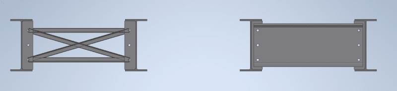

In reality this is where we need to turn our engineering head on an make some intelligent decisions. For the case of LTB I often consider a web cleat as rigid. Eg consider the two examples below:
The one on the left we would normally consider as pinned connections but behave structurally as a rigid cross braced frame. In contrast the example on the right we would normally consider as pinned and the channel gives no rotational restraint to the I-beams. This is clearly inconsistent thinking.
For the purposes of LTB, I consider the connection on the right to be rigid.
