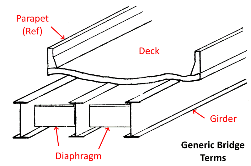

Since this thread is not in the Bridge Forum, the following is for engineers who are not familiar with the bridge terminology being used:
Diaphragms are placed at intervals along length of girders. Diaphragms control girder LTB, especially during construction until the deck is placed. In the completed structure, diaphragms redistribute forces to prevent one girder from being overloaded.
The OP tells us: "The bridge is very wide with variable loading across it. The 3D bridge model resulted in high axial forces in the diaphragm..."
IMHO, force redistribution from the variable loading across width of the deck is probably the cause of the high axial force.
