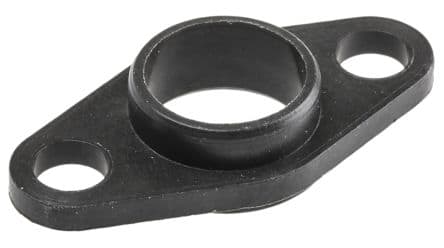

Hello,
I would appreciate if anyone can let me know what is the easiest way to bolt a bearing with 5mm ID and 16mm O.D onto a piece of wood so that it stays in place while allowing a 5mm shaft to rotate. I have attached a photo of the component if that helps. Would putting the bearing inside a 16mm shaft support mount and bolting that work?
Bearing
Mount
Alternatively I am thinking of using a miniature ball bearing with 5mm I.D and 10mm O.D and couple that with a 10mm I.D flanged bearing, I am not sure if that is going to work however?
I think that your first arrangement would work just fine, as long as you don't over-tighten the clamping-screw on the mount, which could compress the outer-race of the bearing, potentially causing the balls to bind.

Cheers Jon! I will give that a go.

"easiest way" would be a 15mm hole in the wood, and a hammer.
or a 16mm hole and some glue.
what does it matter if the housing rotates ? a 16mm hole (blind, ie not thru) would locate it within your wooden structure, then retain with a ply wood (or other) cover.

To build on what rb1957 said, if you go with a blind hole, you can also retain the bearing in the hole with a screw (or 2-3 screws) in the wood adjacent to the hole such that the head of the screw catches the outer race of the bearing. If you want some more ideas for mounting bearings in wood (and wooden machines in general), check out Matthias Wandel's Youtube channel, or his website woodgears.ca. He has made quite a few woodworking machines (bandsaws, lathes, jointers, etc) out of wood that you could pull ideas from.
Cheers for the response Mike, flanged bearing was my second thought and might just work. I imagine my second post with the images fit your suggestion.
