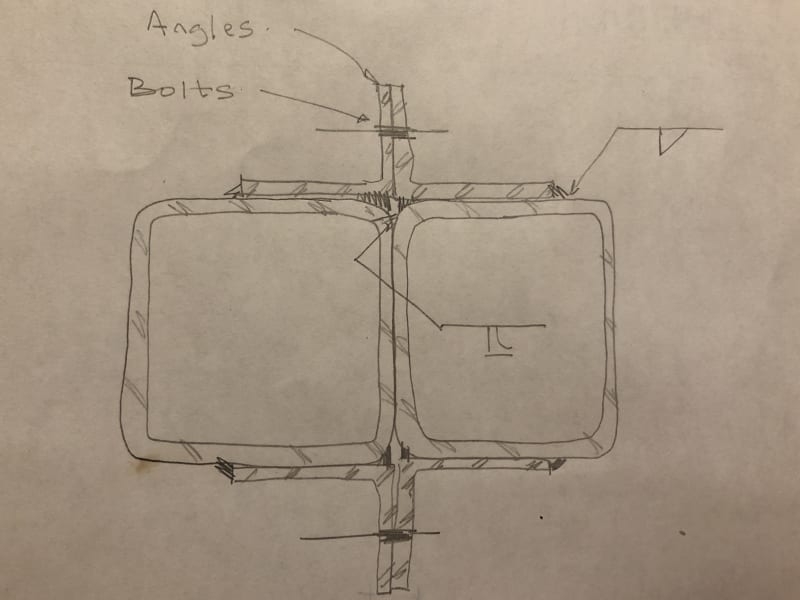

Hi there,
could someone provide some general guidance on how to bolt together multiple hollow sections? I am using only rectangular sections.
Also, I attached the figure below and am interested in which of the two ways is the "correct" one, when it comes to connecting two rectangular sections side by side.

Drill the inner hole diameter for clearance around the bolt. Drill the outer hole diameter for clearance around the sleeve. It will then behave like like the first drawing in the OP. No welding and no need for access to the inside of the tube. Use one drill to drill through both sides of the tube then enlarge the outer hole.
It is a pretty good idea, if large rotation of the HSS is permitted. The contact between the HSS wall and the washer provides friction that prevents movement. The contact can be lost when bearing directly on the sleeve. But the above method is preferred if this is not a single bolt connection.
How about just a thick weld washer to distribute loads out to the flanges?

The HSS section will collapse under the compressive load of the bolt extending from the outside surface of the HSS to the outside surface of the opposite HSS. We all agree on that. The problem is to keep the HSS from collapsing. Several proposals have used tubing to prevent the HSS from collapsing. I propose solution that doesn't require any welding. The tube in any case has to resist the compressive load of the bolt. That would pretty much eliminate a thin wall tube. The capacity of the tube would have to be equal to the compressive force developed by the bolt. So, I call the tube "a heavy wall tube".
The clamping force must be tranferred to the faying surface where one HSS wall bears directly against the other. I believe that is accomplished by my solution. Note that the heavy plate washers bear directly on the heavy wall tube at both ends. The ends of the heavy wall tubes bear directly against the inside of the HSS walls. There doesn't have to be any welding. The weld would have to sustain the full forces of the bolt, which is no small task. My solution requires access from one side of the HSS sections, so the connection can be placed anywhere along the length of the HSS. If the heavy wall tubes are a little too long or a little too short, it doesn't matter as long as the plate washers bear directly against the heavy wall tubes. See the attached sketch.
Best regards - Al

retired13, you weld the clip angles to the HSS and then bolt them together.
