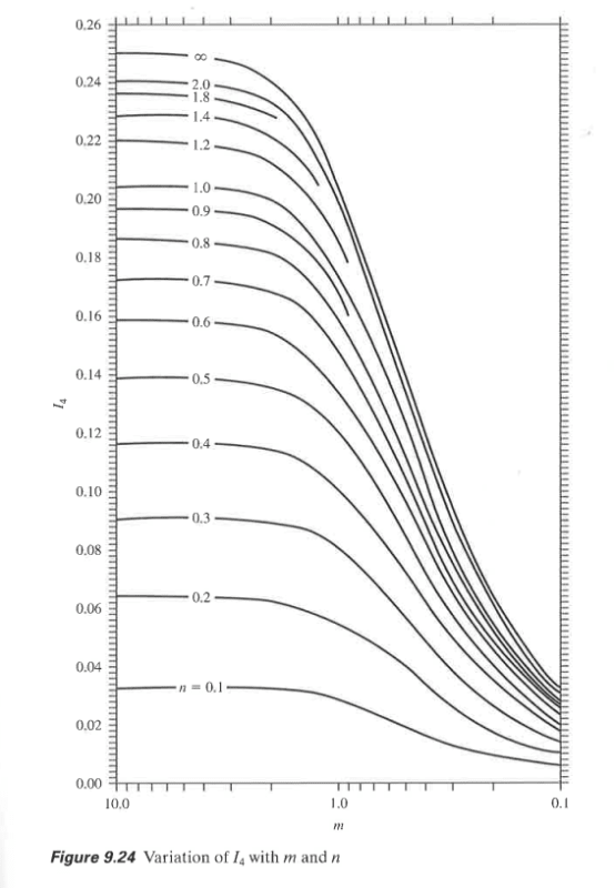

Does anyone have a closed form equation for Boussinesq surcharge below corner of a rectangular area? I'm struggling to get the closed form solution provided in Das Equation 9.35 to mach the results on the curves shown in Figure 9.24 for m=2 and n=2. Please see page 3 of the attached pdf reference.
I am trying to program this into a python script and not obtaining correct results, and have checked everything quite a few times so just looking for a sanity check that Das' integration was correct (I'm sure it is). I'm having similar issues with the equation for NAVFAC DM7.1 Figure 2's equations as well for B = 20, L = 20, and z = 10 (i.e. m=2, n=2)
I am calculating an I value of -0.0175 using both Das and NAVFAC 7.1 equations.

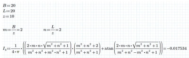

I get your answer. Here is what it looks like in Mathcad Prime 5.0.

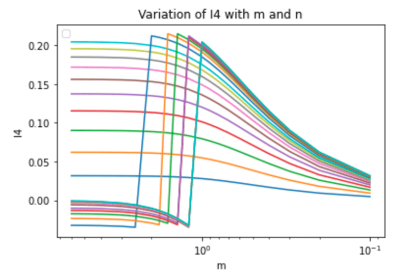

Does anyone happen to know the limitations of this equation or if Das was wrong with the integration? I did a parametric study and plotted I vs m for varying values of n which seems to show almost a phase shift once values of m and n become greater than about 1, pretty interesting so makes me think it has something to do with the trig.
Python Output

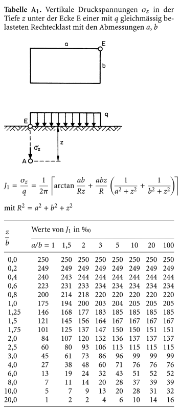

The problem is that you somehow get a negative term in arctan and the solution have to be positiv.
Try the absolute value of the term in arctan (im not sure if this works) or the following formula, its from "Bodenmechanik und Grundbau, Lang Huder Amann Puzrin".
I get about I=23% which should be right.

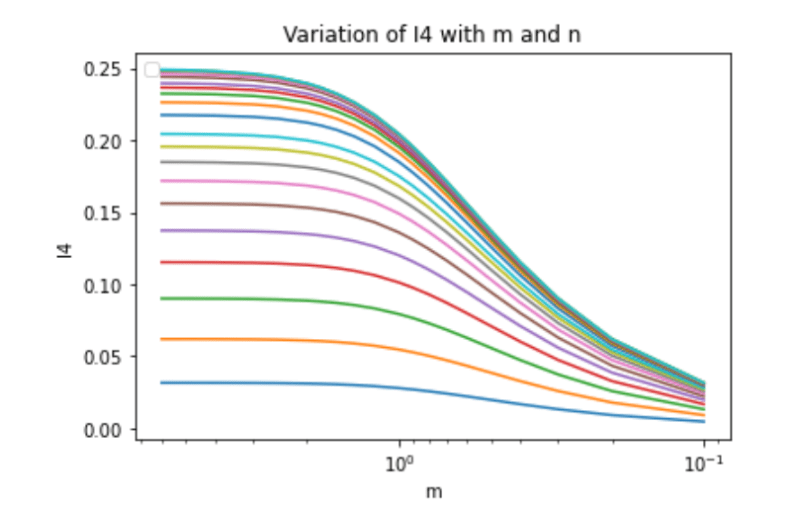

My script obtains 0.2324662539661108
Here is the script if anyone wants to hack it into their own library.
