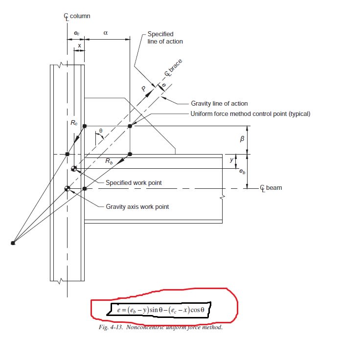

if i design a bracing with working point at top of baseplate where no eccentricity to be considered
and then a 6" slab is poured covering 6" on top of baseplates
what effect does this have?
also in a redesign
could i consider this 6" above baseplate
a new working point without eccentricity consideration

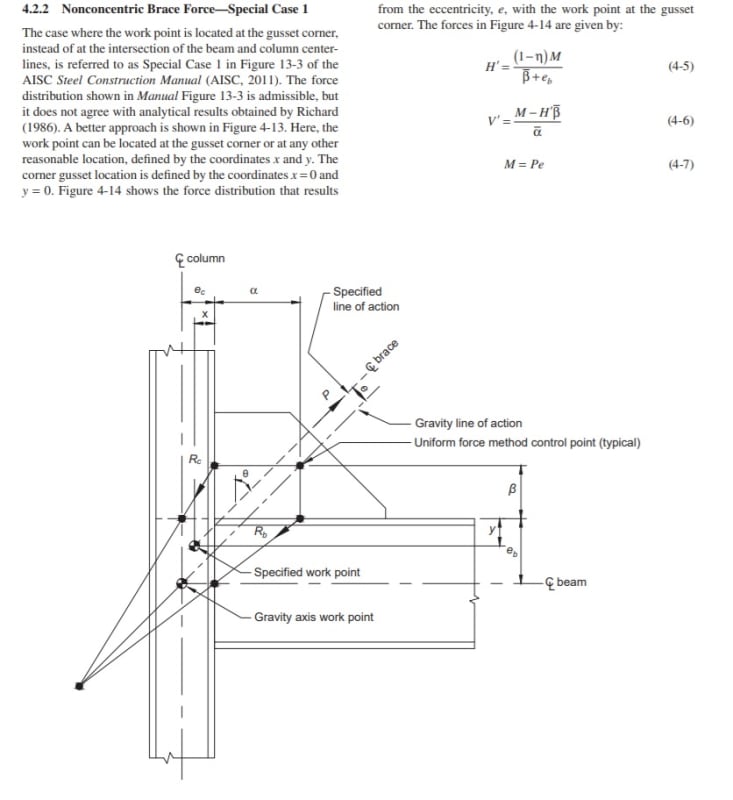

Do you have access to the AISC steel construction manual? If so, check out the uniform force method special case #3 (page 13-9 in the 14th edition). It's similar to your situation but reversed - connected to the beam but not the column. Good example for how to balance the forces and moments. I know it's simple statics, but it's easy to lose that in the complexities of the brace connection design methods.

phamENG yes i have considered special case 3 it however still works with working point at centroid intersection
for working point outside of centroid intersection
they talk about a moment P*e with e being the distance between the alpha - beta*tanteta = e[sub]b[/sub]*tanteta - e[sub]c[/sub] line (uniform distribution)
and the new brace line which in the example seems to be parallel
the new H' is developed from lets say for my case P*e/betabar
im guessing this Pe would relate to He + Ve[sub]c[/sub] ?? cant confirm this

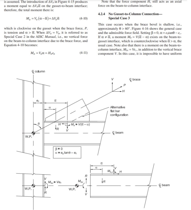

my situation has eccentric working point and zero baseplate connection
the admissible force field posted about with Fig. 4.22 includes Hb
im just wondering if could use the same force field and neglect Hb
and use the same H*e + V*e[sub]c[/sub] to develop H[sub]c[/sub]
No, I don't think you can. The case you posted up there resolves the moment at the plate to column interface with the horizontal reaction at the base plate. Since you don't have that connection, the statics will resolve themselves a little differently, and you'll have a moment at your gusset to column connection.
Remember, these formulas aren't hard and fast rules - they're just common cases that have had the statics pre-figured for you. Since you don't fit nicely into one of the boxes, you have to start from the beginning.
ok lets look at e
Pe = P(e[sub]b[/sub] - y)Sinθ - P(e[sub]c[/sub]-x)Cosθ
this turns out to be
Pe = H(e)
the column example is H(e) + Ve[sub]c[/sub]
@phamENG i see what you're saying i should consider H(β-e) - Ve[sub]c[/sub]
since there is no H[sub]b[/sub]β to resist it?
at the gusset column interface
so my tension yielding for gusset should be
Hc and H(β-e) - Ve[sub]c[/sub]
I haven't checked your math or the statics, but that sounds vaguely correct.
what i think i meant to say here is
if gusset centroid and gravity wp coincides F[sub]b[/sub]*betabar becomes F*beta+V*e ?
