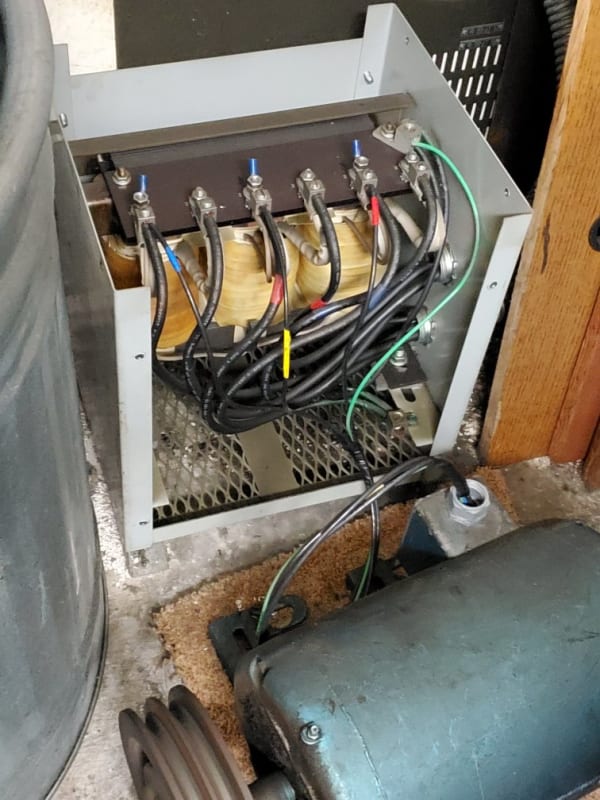

Most machines have buck transformers to get the ODelta 240Vac down to 208V (Japanese machinery).

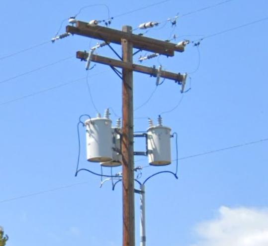

That teaser is holding the three phase load now. No need for a full blown wye setup with the majority of the load on the large transformer.
A second small teaser on the left side of the cross arm would supply 120-208 Volts as well as 120-240 Volts.
The metering is easily doable.
That may bring the cost down under $50,000
Guesses based on a pole and transformer installation about 10 years ago.

The two transformer solution is fairly common. I have seen it from The Yukon Territory to Honduras and points in between.
(I used to get out a lot.)
In a non industrial area served with 120-240 volt single phase power, it is a good solution to provide a small teaser transformer to drive a small three phase motor.
The motor and small transformer generally sort out between them any unbalance issues, often with no problems.

The two transformer 3Ø solution is what was used exclusively around here up until about 10 years ago when the three transformer wye (208) fashion came into it's own. Having driven back from WA via Oregon recently I was amazed to see that EVERY 3Ø service I saw in OR was now three transformers mounted 120° around the poles (probably to keep the phases properly balanced). I believe whoever supplies power in OR decided 'they shall all be Star'. Probably a power company that actually re-invests in it's infrastructure, something that, of course, doesn't exist in N.California.[cry]

Please take a close look at the "buck" transformers. I suspect a three phase, three core transformer with a floating wye point.
A floating wye point is a common mitigation of wye:delta issues, whether from a delta winding or from a phantom delta.
Talking to the owner today all his machining centers each have a "buck" transformer (he calls them). He described classic vertical E core configurations with coils on "each arm of the E". I'll lay eyes on them tomorrow.
This leaves me wondering. worth a close look.

Hi Bill W.
I understand. I never saw an open delta until I moved away from BC.
The mounting brackets that Keith mentioned probably allow the mounting of larger transformers than would be prudent on cross arms.
The mounting brackets that i have seen are heavy galvanized steel.
Did you ever have anything to do with Kelly lake sub or Cathedral sub?
Bill
"Why not the best?"
Jimmy Carter
I was actually joking about the balance. However! Very logically they appear to be trying to balance the weight distribution so it's not going to throw decades of lean into bending or twisting the poles. I think the slightly wider gap is so a lineman could actually maneuver thru them.
Keith Cress
kcress -
Right on all counts Keith.
A lineman with a short hot stick will have space to pull the cutouts.
I wouldn't want to put those three transformers on a single pole cross arm.

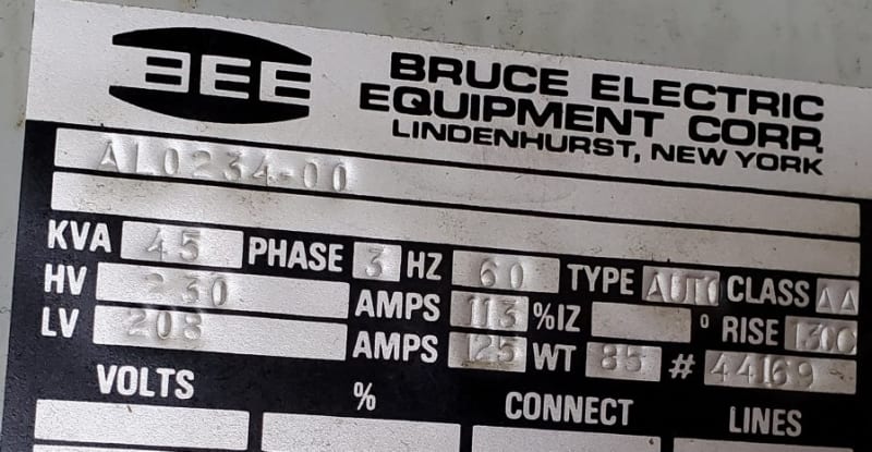

I got by the place today. Sheesh. Probably 16 machine tools crammed into 3 bays.
One a lathe with a 15hp spindle is bucked with this transformer. Clearly an auto transformer. Heck, it's 45kVA in about a 7kVA box! I've actually never seen one like this.
Note the running 5hp motor on the load side which actually improves the balance a couple of volts.
I measured the line coming into this transformer as a stake-in-the-ground 244V, 245V, 233V. Hows that for an imbalance! Gads.
I started looking in panels and discovered they're using the neutral bus for the ground bus with complete ignorance. Only one panel even has a ground bus and it and the neutral buses are both randomly loaded with grounds and neutrals and the bonding screw is installed.
Looking in only one panel their single phase is badly balanced 18A on one leg and 3A on the other.
I've prescribed:
1) Correct the grounding situation. Install ground buses and separate the grounds out from the neutrals.
2) Balance the single phase loads by making changes while watching the three phase voltages NOT the currents.
PG&E will be replacing the transformers Wednesday.
There is a possibly that one of the big lugs up in the air is crapping-out. They had that happen about 4 years ago and PG&E didn't even bother to re-do the other two..
Keith Cress
kcress -
The magic of multiplication and why I like auto-transformers to adjust the voltage.
A conventional transformer with 208 Volt and 22 Volt windings can be used in place of that auto-transformer.
With the 22 Volt winding rated for 113 Amps, that would be 4.3 KVA. (22 V x 113 A x 1.73 = 4300 VA)
Or with an open delta connection and two transformers at 2.5 KVA each. (22 V x 113 A = 2486 VA)
Note calculated for 208 V up to 230 Volts. The calculation is a little easier.
