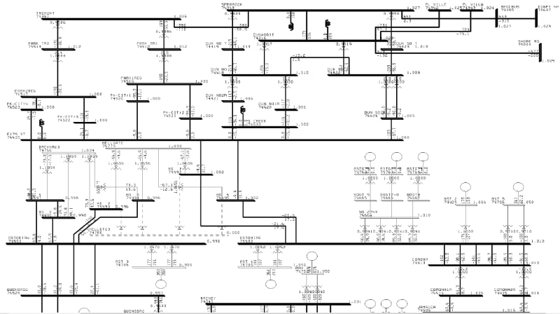

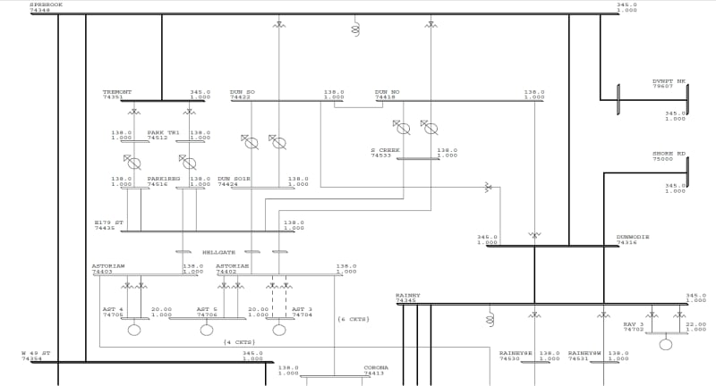

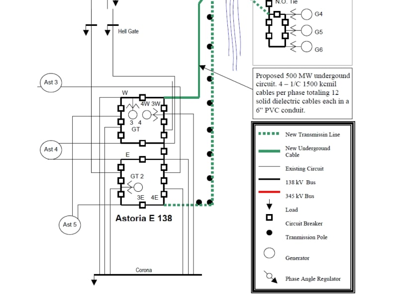

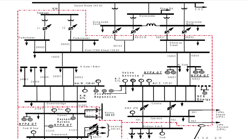

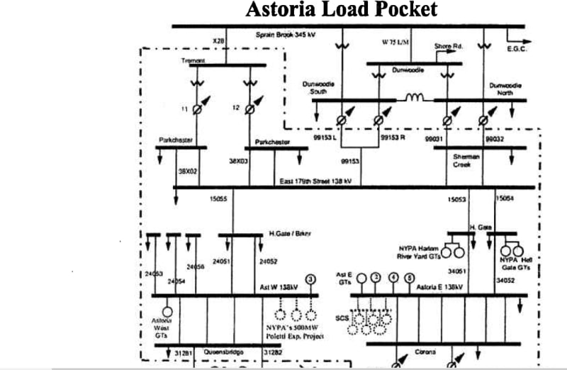

If anyone is curious here is the three terminal line involved in the incident, as taken from public docs.
Two lines come from Astoria East and head toward East 179th st, both tapped feeding load transformers and generation but not connected to transmission. Both has a series reactor without bypass as Astoria East.
4-5 lines leave Astoria West. 3-4 of them feed load transformers only, two of them feed load transformers, combine, and then via single cable head to East 179th st. If I am correct this single cable has a phase angle regulator with bypass at 179th st.
I'm with others, it is unconscionable that the stand alone zone of protection does not include the reactors at Astoria East.
Bigger view:
