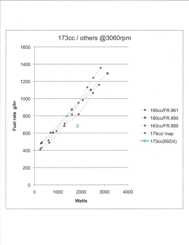

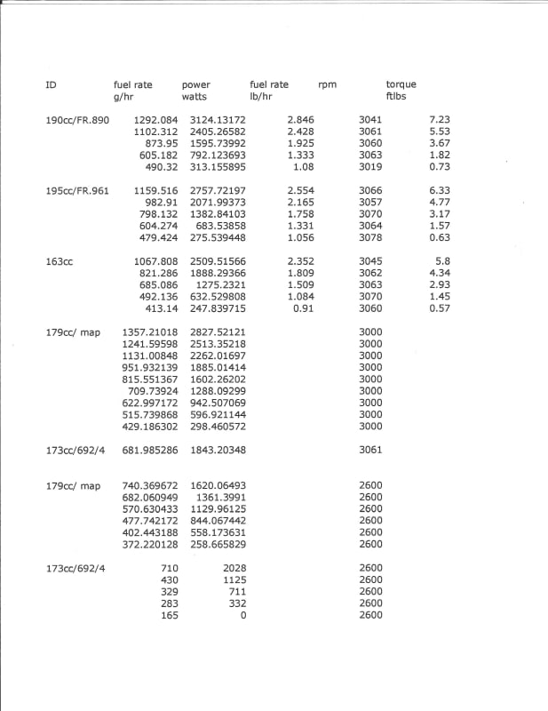

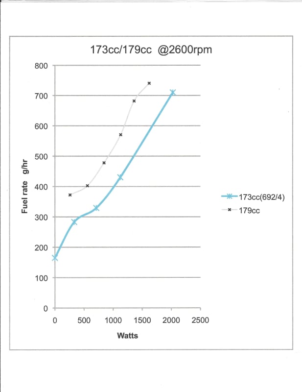

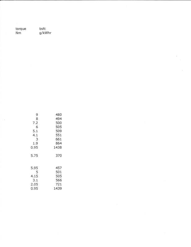

Below are a couple of links to BSFC numbers for engines with similar technology criteria and displacement per cylinder. Does anyone have any numbers that would indicate for this type and size engine that these numbers are incorrect? The first link shows a sweet spot of about 440g/kW hr.for 179cc engine. The Brickley Engine is 173cc per cylinder and I am obtaining 350g/kW hr. The other link indicates numbers much higher than 440 g/kW hr and they will have to be converted from lb/Hp hr. I used the 3/4 throttle numbers. Your thoughts?
I believe the other engines you are comparing to, are all air-cooled engines with integral cooling fan whose power demand would be incorporated in those measurements. Is yours the same situation?
Not exactly. Air cooled, similar carbs and mufflers, yes, but my engine does not have a cooling fan. Why do I think they can still be comparable? The work of the cooling fan is replaced by the work necessary to drive the two preloaded tapered Timken roller bearings and hub seal that support the two caliper disk brake for the prony brake. As I had mentioned previously, a small crank-speed oil pump adds a small drag that I don't believe any of the other engines have as well. I would not be surprised if my setup actually has more drag on the system than a fan. Something more to test.
