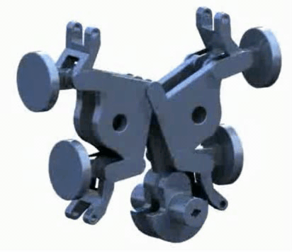

Wow. Interesting. I count 25 spots where something pivots, not counting the crank main and big-end rod bearings, several of which may share a common axis, 20 spots if you count the spots where three things pivot on a common axis as one each. And presumably it will share the general design of a valvetrain mechanism with a normal engine, except if you use a normal cylinder head arrangement the camshaft has to spin at an axis perpendicular to the crankshaft - can't just use a normal timing chain or timing belt, it needs to turn the rotation 90 degrees - and two such mechanisms since it is an upturned flat-four thus needing two cylinder heads. Or maybe there's something unique planned for valve actuation as well, which isn't shown there.

I split the case halves on the Web for a look at the real thing. Maybe you haven't seen it.
I'm assuming posting a link to my website is fine with forum posting procedures? I'll be glad to remove it if my assumption is incorrect.
Link
So the design seeks to reduce friction by replacing rotating bearing surfaces with oscillating ones. Also (I assume) by eliminating side loads and rocking of pistons.

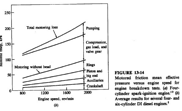

Looking at Greg's chart, eliminating the pistons and crankshaft completely still wouldn't achieve the 50% friction reduction claimed for the Brickley Engine.
