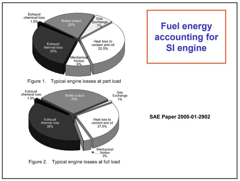

Per the chart below from an MIT class on Engine Friction and Lubrication, mechanical friction accounts for 3% (full load) to 9% (part load) of engine losses. By my calculations, a 50% reduction in skirt and bearing losses would result in efficiency gains of 1% (full load) to 3% (part load). That would be a pretty significant accomplishment in my opinion. Whether or not that gain can be accomplished and what increase in cost and complexity manufacturers are willing to accept to attain it is beyond me.

I can't tell you how many times I have re-calibrated and improved my test equipment because I have not believed the results I am getting. I must say at this point that the gains are far more than 1 % at full throttle and 3% at part load.
The Harbor Freight engines that I cannibalized have pushrods that run along the side of the engine. I kept all eight pushrods on the same side of the engine by turning two of the cylinders upside down. All four pushrods that meet from the two cylinders opposite each other are actuated by one cam lobe via roller followers. One lobe, two cams placed one above the other, chain driven from the crank. Two lobes drive all eight pushrods.
Congratulations! That's very impressive! There's should definately be a market for those kinds of gains.
