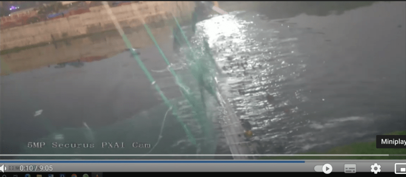

Another video shows the moment before the bridge collapse. The footage also show only left main cable left after the right main cable gave away. The fact the right cable wasn't seen after collapse is significant because of the failure could be at one of the two main cable of the bridge. Latest death toll is 141.

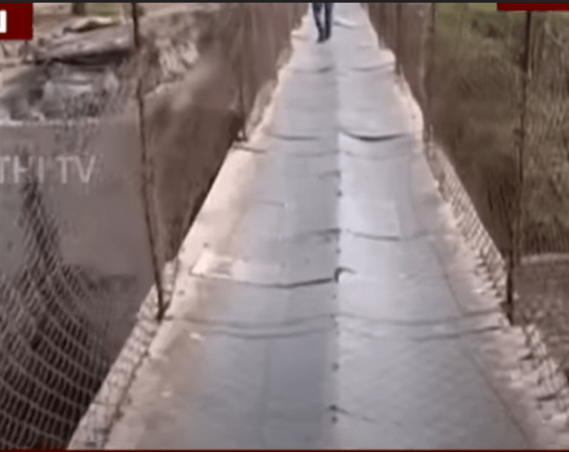

Condition of footbridge before renovation showing deck's steel plates grossly deflected and worn out.

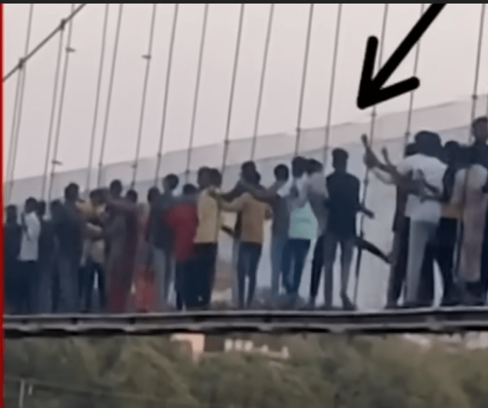

After opening to traffic pedestrians were seen shaking the kicking violently the hangers. The original video seems to have been removed possibly by the authority.

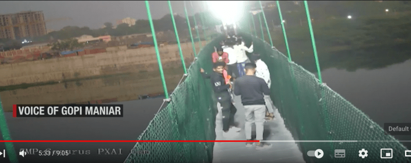

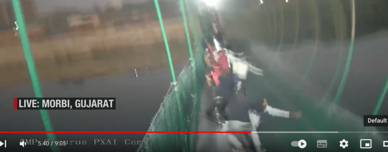

A few second prior to collapse people were bouncing and swinging at the deck

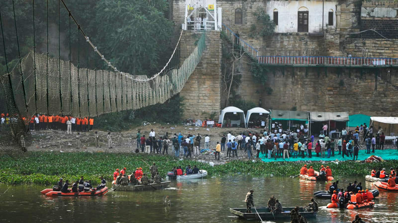

This picture depicts one main cable gave away during collapse
Remaining cable still hanging but the other side was clearly has gone missing

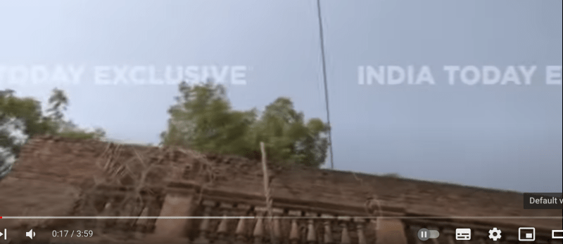

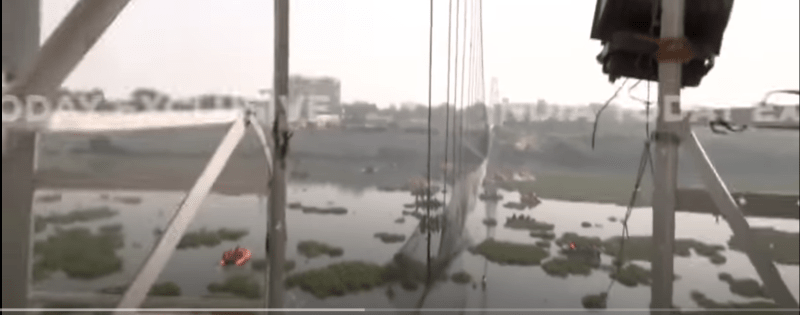

In the morning only one cable with empty hangers remained as shot was taken at the tower

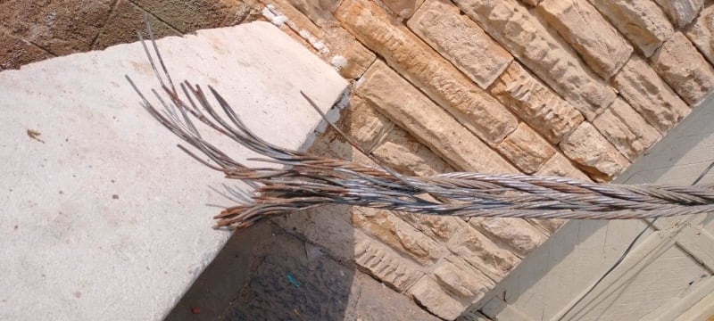

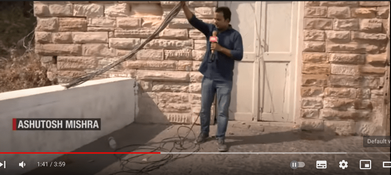

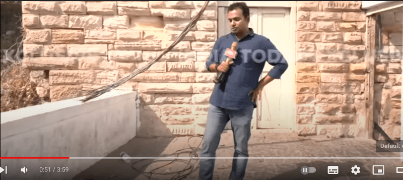

An Indian journalist indicated this was the severed main cable. The position would suggest the cable might have broken off possibly at the top of the tower where the wheeled saddle joint would be located.

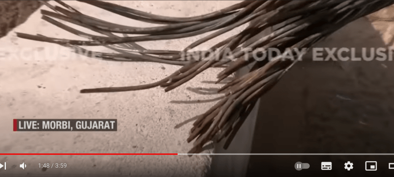

The tendons do show signs of tensile failure with necked ends indicating yielding took place at an excessive strain.
News reports state the pedestrians were attempting to force the bridge to sway during celebrations.

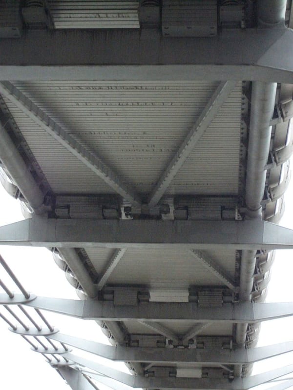

That is a modern phenomenon. The public likes to test anything that moves and vibrates to get high and to be cool. This also happened when the Millennium footbridge was opened in 10 June 2000 in London. That bridge vibrated sideways because it uses cables as the main support.
Londoners nicknamed it the "Wobbly Bridge" after pedestrians experienced an alarming swaying motion on its opening day. The bridge was closed later that day and, after two days of limited access, it was closed again for almost two years so that modifications and repairs could be made to keep the bridge stable and stop the swaying motion. It reopened in February 2002.
The modification was the addition of dampers to restrict the swaying motion that was previously amplified by the pedestrian traffic.

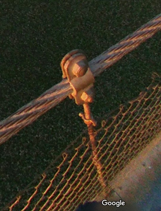

This from before hand.
A more likely location would be the top of the towers though.

Whilst a little imperfect this picture of the cable break shows what seems like a rust exterior with may of the cable elements broken with what remains looking very like a stretch to beyond yield. The lower strand has actually unwound so if you wound it back I think it would be pretty much level with all the other broken ends. I suspect this is either at the top of the tower or one of the first long vertical hangers. So it would look like about 2/3 of the wire core had already snapped before the events of the reopening took its toll.

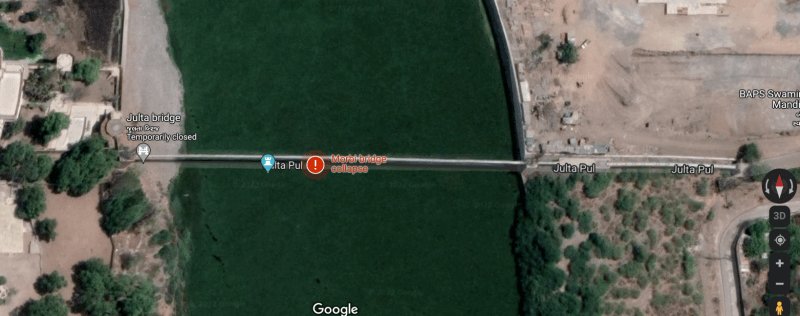

Here is a screen capture of the Google Map. It appears the west side has a dry beach area but the east side has water flooded to the boundary wall.
Therefore this is the west side as it has a dry beach. The south side main cable is missing. The one left is the north main cable. Note behind the steel tower there is a large masonry wall. The west side after collapse also had no deck structure attached.

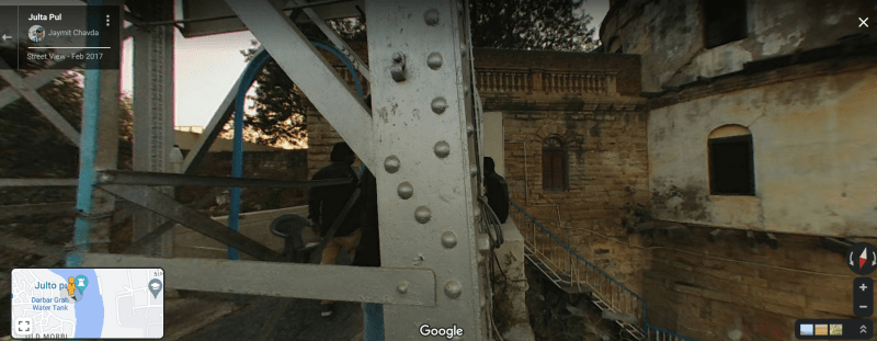

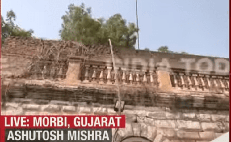

This is a screen capture at the west tower before renovation. Behind the tower there is a large masonry wall with a white door, some ornamental columns at the top of wall. Looking through the tower steel work there is a white parapet wall between the west tower and the masonry wall.
Thus with the masonry wall background we can establish the south side main cable has snapped off
The ornamental columns at the top of the masonry wall confirm this is the west side and the south main cable is down whereas the north side cable is still up in the air on the tower.

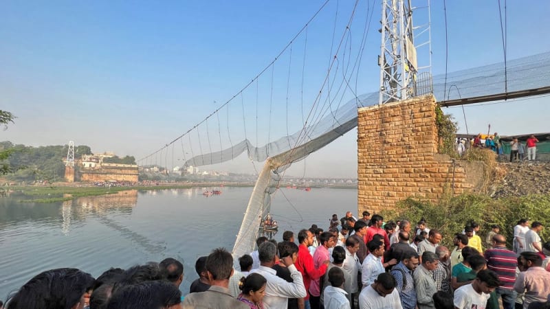

Now the east side
This is the east side. It has a broken deck still attached. Two main cables are still visible attaching to the twisted deck. Its side span has hangers and there is no masonry wall behind the tower.
A front elevation of the East tower showing no masonry wall behind the tower and the water flooded to the boundary wall without any dry beach area. Two cables can be seen still attached to the tower.
