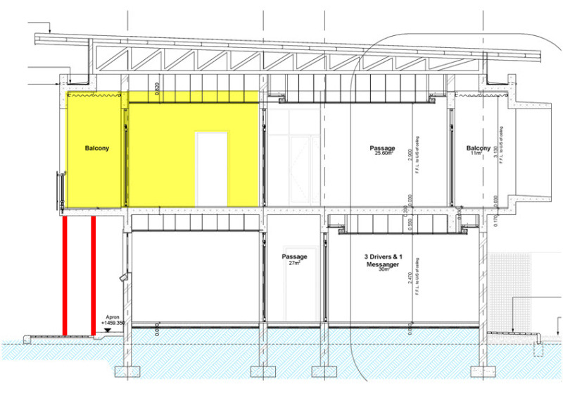

Hi, I have some problem because the contractor was building brick walls on propped structure.
Now what happens after they "de-propped" the slabs, the bricks started to crack here and there.
How can I prove to the contractor that this was wrong? Obviously he is now arguing that why was he not supposed to build the brick walls on propped structure.

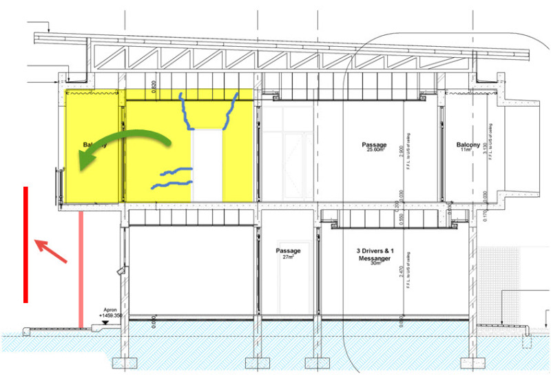

You missed the bit about the slab still being propped when the wall was built. So the wall experiences the full deflection including the slab Sw and the wall weight as well as loads added afterwards and the resulting cracking effects. And the long term effects as mentioned by Ingenuity.
rapt,
Yes, I missed that. So, what is the total deflection?
Hi guys, I am quite surprised about all the comments. Thanks for all the infos. Let me uplaod an image which will explain what was happening.
and this is what is happenign after removing of the propps

Bottom line here to the original question - "why was he not supposed to build the brick walls on propped structure" is that the prop was a temporary construction feature - presumably included by the contractor - to assist with construction of the base slab. It was not part of the permanent design and therefore needs to be removed prior to building anything else on it.
So unless you told him to build the brickwork with the props still in place, the responsibility and schedule for any temporary construction works remains with the contractor. End of.

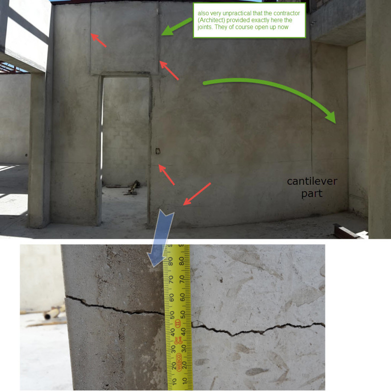

Is the cracking at the mortar joints, or, through the masonry units... almost worst place for a door opening with the large cantilever on the left... Judging from the sketch, it appears cracking through the masonry units.

I attached a photo of the site
