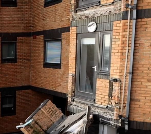

Looks a very ropy design.
Thin flat cantilever slab with brick sides. Some level of static load there.
Random balcony departs structure disturbing the one beneath. Neither survive. Note to residents ...
There has to be something missing when they were building it.
Depends if it was designed to hold that weight of bricks or if they changed it at some point.
I reckon there was 1.5 tonnes of bricks on that weedy 100mm concrete slab with not much rebar by the look of it
The balconies were cantilevered. I surely don't see why, since the tie-back could have been inside the brick walls of the balcony.

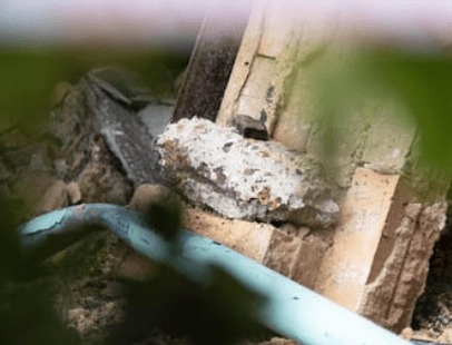

...with not much rebar by the look of it
I don't see any bars extending out of the building, nor out of the slabs that fell.
It could be that there was a construction joint right at the exterior building line that
rusted away the bars all along that discreet line, but ALL of them at the same rate/time such that none are sticking out?

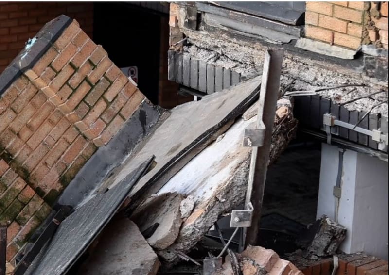

I can see three weedy little bars projecting from the building at the right edge, and some black dots in the slab edge, about mid-depth. Little in the way of design and construction supervision, I suspect.
Or insufficient overlap of bars?
It's the weight of all thoss bricks that gets me. Plus it's very likely to ba a construction joint there as well.
It's an easy design problem... if done properly.
The weight of the bricks obviously contributed, however heavy brick balustrades on cantilever balconies are very common. The issue here is the defective slab, in particular what appears to be defective reinforcement detailing, which failed in a brittle manner, not the fact it's carrying some bricks.
OK - so I stand corrected - a few bars are sticking out. Missed those when I glanced at the photos quick.

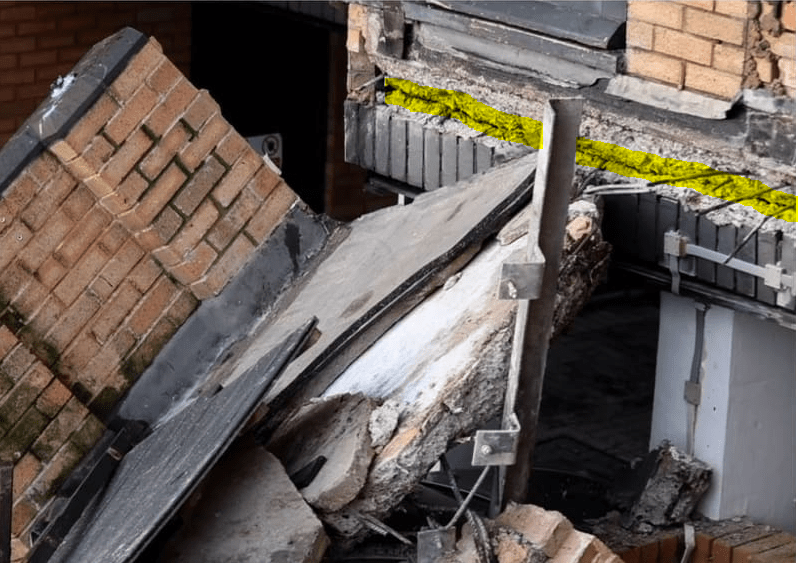

Some rust staining in a few of these photos. This looks like a combination of one or all of the following: corrosion due to poor waterproofing; anchorage failure of the cantilever bars possibly due to corrosion or poor detailing; overall insufficient reinforcement.
The upper slab in Tomfh's photo looks like it has no remaining reinforcement sticking out whatsoever, as though what few balcony bars were there in the first place have just pulled straight out.
The lower slab looks like it has split in half. Is this an anchorage failure of the cantilever bars? Or possibly a secondary effect of the balcony yanking downward on the protruding bars as it fell?
To be fair the lower one had every right to fail if the upper one fell onto it, even if there was nothing wrong with it.
That's my reading of it. Those bars started peeling off the bottom of the slab, prior to breaking.
