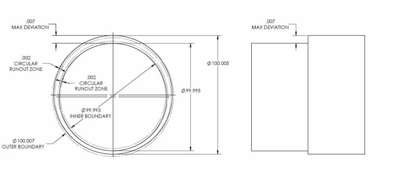

Attached is a figure explaining the principle behind the .007 calculation above. I altered the numbers to make the bump more visible. Note that nowhere on the figure the circular runout full indicator movement exceeds the specification tolerance.

That is not what I would call a "bump in the surface". That is a ring or groove, not a bump.
I am with CH on this - the use of the term "bump" is imprecise. If we take it to mean form deviation in each radial cross-section the limit is of course dictated by the circular runout tolerance. If we take it to mean form deviation along the entire axial length of the part, it is now dictated by a combination of the size tolerance and circular runout tolerance.
If we are to take the former definition the limit is .002 dictated by circular runout.
If we are to take the latter definition, I agree with Sem_D220's calculation. A more simple way to think about it is in terms of the feature's inner and outer boundaries. The allowable form deviation would be half the difference between the inner and outer boundaries.
Outer Boundary = 100.005 + .002 = 100.007
Inner Boundary = 99.995 - .002 = 99.993
Form Deviation = (100.007 - 99.993)/2 = .007
Note that this is the case because both extremes can exist simultaneously (ie: portions of the feature can touch each boundary) along the feature's length due to circular runout - the same would not be true of total runout.
See the figure I created below - I know the sharp transition is perhaps not realistic but hopefully exhibits my point well. It may not be clear from the figure but the 2x .002 circular runout zones shown are concentric to each other - this would be the datum axis.
*Edit: I should note, this is not to scale. As Sem_D220 noted, the tolerances utilized in the example are too small to see otherwise. The figure just graphically exhibits the calculations I showed.

I still don't understand the point of the exercise.
It is common knowledge that circular runout is less strict control than total runout, so circular runout cannot control all the aspects of a form.
The "bump" on the illustration will produce circular layout of 0.2, but total runout of 0.7
So the question "bump size to be measured within the same circular section or from one section to the adjacent one?" is sort of bogus - circular runout does not measure "from one section to the adjacent one", that's what total runout is for.
