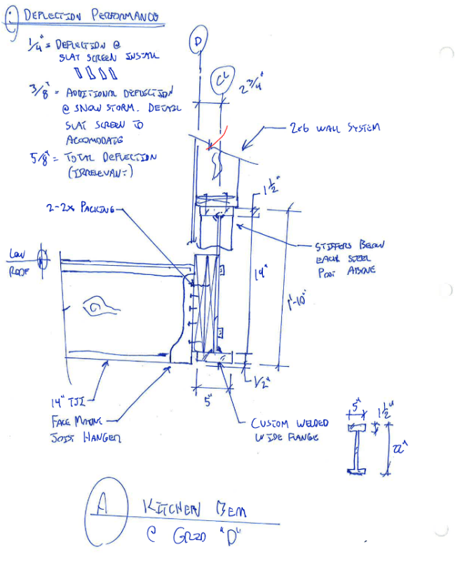

I've got an architect wanting to hide some 30' steel beams inside a 2x6 stud wall system. This tends to restrict the pool off off the shelf W-beams that would be workable.
In what can only be described as an egregious tactical blunder, I mouthed off that even a 5.5" beam flange cannot be hidden in a 2x6 stud wall cavity unless one is willing to allow the walls to move to suit the in place beam locations when one considers tolerance issues such as permissible column misplacement and lateral beam sweep.
In response, the architect would now like me to stick to 4" wide beams to allow for the tolerances that I mentioned. So, yeah, that did not go as planned. Many of the beams would wind up having to be custom fabricated sections which would likely wind up having even worse sweep than rolled beams as a result of the welding heat introduced.
My question is this: is the normal thing to do in these situations to allow the beams to be 5.5" wide and just adapt the architectural system locations to suit? Put the walls wherever the beams wind up laterally? I feel that is indeed the case but I'm not positive.

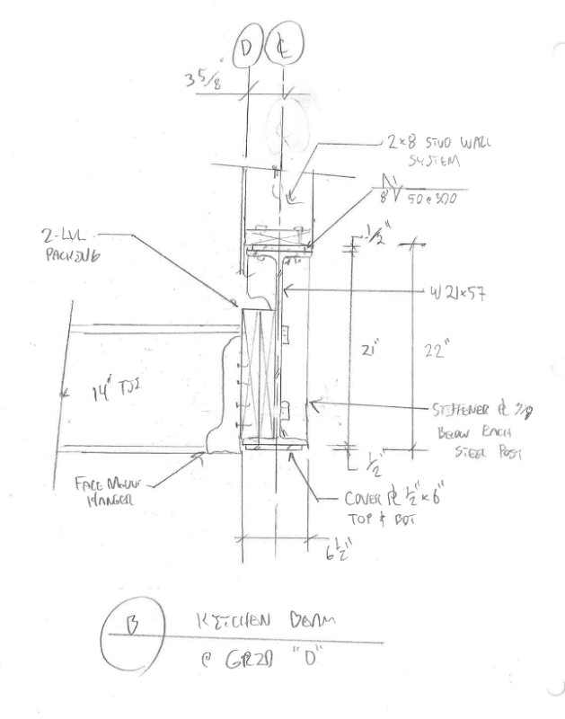

This is a high low condition at a roof step. The low beam will do all of the work and needs to clear span. The upper beam will be much small and is to be supported on 1/3 point 3x3 HSS posts in the clearstory window system above. Two of the options initially proposed are shown below (welded WF and off the shelf WF). This should illustrate the flavor of the thing.
Initially, the architect chose the welded WF beam solution. Later, in the process of trying to figure out why our models did not match, I discovered that they had made the wall system at the clearstory 2x8, similar to XR250's suggestion. So we went back to an off the shelf WF. In the end, the architect decided that they wanted the 2x8 system for their own, thermal performance issues.

Can you use a 2x8 wall?
Indeed. Can, and have.
