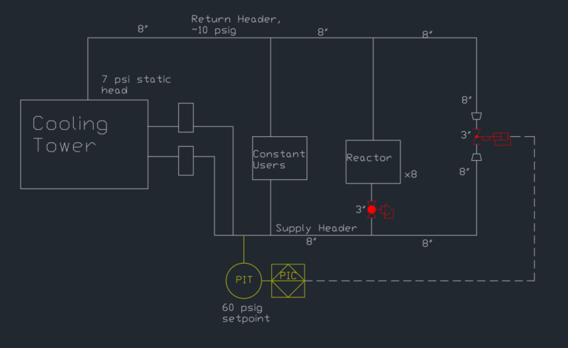

We have a 3" butterfly pressure control valve installed on a cooling tower water recirculation loop. This valve is controlled to a pressure setpoint from a pressure transmitter located at the outlet of the cooling tower water pumps (combined header). The cooling tower water loop has a mix of constant users and sporadic users. Normal operation at no sporadic user demand is ~65% open on the valve; however, this valve often operates 0-20% open during heavy user demand to maintain supply header pressure. Some operating data is below:
Valve: Bray Series 30/31, 3"
Pressure setpoint: 60 psig (at CTW pump outlet)
Valve Upstream pressure: 50 psig
Valve Downstream pressure: 10 psig
Cv (20,40,65) = 15, 61, 210
Water temperature: 75 F
Main header: 8", reduces to 3" for the control valve
The 3" schedule 40 carbon steel pipe (ASTM A53, I think?) developed pinhole leaks about 3 months after installation. The valve disc and body itself look fine, but the weld line of the downstream flange and 1-2" of piping beyond the flange were worn extremely thin. Orientation-wise, this is the area where flow is directed by a partially open butterfly valve.
The up/downstream pressure vary slightly based on demand, but dP across the valve is usually 40-45 psi. I don't have equivalent orifice size to get actual flow rates, but at 60% open the valve is flowing ~1,300 gpm. In a 3" open pipe that is ~58 fps. (I don't have data or an equation on equivalent orifice diameter, but a naive assumption of %open = % reduction in equivalent orifice size would put velocity more in the neighborhood of 90 fps through the valve itself. I think we are likely cavitating in the liquid as it accelerates through the valve, and the downstream piping is bearing the brunt of the damage.

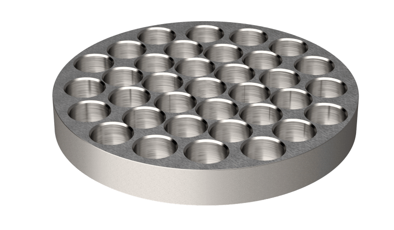

I've had maintenance hardface a new spool with 3/16" tungsten carbide in the wear area to be replaced, but I'm also considering putting in an upstream orifice to lessen the dP required by the valve.
Does anyone have any suggestions or caveats for putting an orifice upstream - i.e. minimum pipe diameters needed to full flow re-establishment? Space is tight, so something like 20D isn't available unless I put an orifice in the main 8" before the reducer.

But assuming you can't or don't want to change the system or valve, I would go for 5D min for a restriction orifice. You might need to stick in a flow conditioner disc before the valve and maybe stick one in straight after?

To clarify, the control valve is not a minimum recirculation control valve. It is a pressure control valve located between the supply and return headers of the CTW loop that supplies a couple dozen users of cooling tower water. The constant users account for enough flow that a ARV is not required. When more users come on-line, the PCV shuts to maintain supply header pressure.
60 psig is the BEP of the CTW pumps, so the control system is set to attempt to maintain them at that point. System demand is ~700-800 gpm from constant users, and total demand can be as much as 3,000 gpm - near the end of the combined pump curve, but not off of it. OEM (Bray) recommends 25-70% open operating range, which we normally fall into. However, heavy use cases during peak demand sometimes call for the valve to close to less than 25% open to drive water to the users (reactor systems) rather than bypass into the return header.
This control scheme maintains constant source pressure so that reactor cooling control loops have a consistent response when cooling is open (i.e. when a reactor cooling control valve is open, having 60 psig all the time as supply pressure helps with tuning and process control). Before this change, CTW source pressure could be 65 psig or 40 psig, which made tuning the reactor control loops nigh impossible.
The original valve was a 6" butterfly of unknown origin. It never worked due to being oversized. The 30/31 Bray valve is intended for modulating service, but is a simple disc construction to allow for high Cv range. Other valves were considered in the replacement, including globe control valves. However, the area of installation is REALLY tight, and the required globe valve size (6") would not have fit without significant (costly) rework. So yes, I would have preferred to use a globe valve like we do elsewhere for flow control, but the project was DOA with the additional rework costs.
All in all, the valve is functioning as intended in the control scheme, but the pipe wear needs to be mitigated.

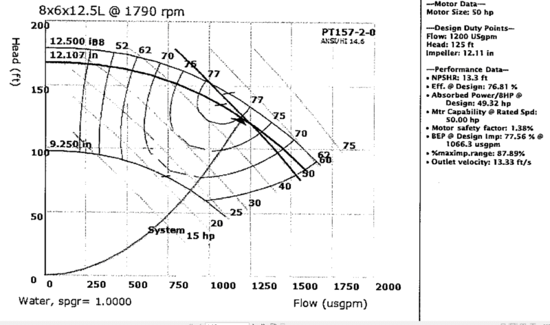

I realise you're asking a different question but would be good to see the pump curves as BEP is, as I'm sure you're aware, a place on the curve, not a pressure.
At the end of the day it's about power not BEP so even though it's not on BEP, if your pump flow is controlled to a lower flow, you probably use less power than recirculating loads of flow through your little butterfly valve. You can still control on pressure, but if your normal users are above the min flow then I don't fully understand why you actually need this valve instead of putting a CV d/s the pumps before the header. If you can get rid of the valve then it makes life a lot better for everyone.

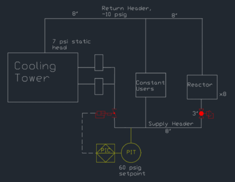

Sorry, Control valve downstream....

Basically in metric units at your 60 psi / 1100GPM you are using in shaft power about 36.5kW
If instead of this valve you instead placed a control valve ( butterfly would probably work here) d/s your pump but still control to 60 psi, then as the demand reduced the control valve would cut in to reduce pressure. Then although you're not at BEP, and you are generating more pressure, you at at much less flow.
So the shaft power reduces to approx 30kW.
So you get a 6.5kW saving all the time you're running at your "normal" flow. Depends how much time it operates like this and how much electricity costs, but it could be worth saving.
Plus you won't have to fix the 3" valve pipe.

Please describe what you mean by downstream pressure control valve. See sketch below for generic cooling loop setup. There are something like 25 user lines, so this is quite simplified.
We have two pumps in parallel. Each is 50 HP, so your calc on power draw is accurate.
Where exactly would you move the valve? All the reactor loops are designed with the ~40 psig available pressure drop to achieve required flow and control. As more reactors come on-line (batch process, so number of users is changing often), the header pressure drops. The PCV then adjusts to maintain pressure at 60 psig. The PCV MUST be downstream of all users to maintain a constant source pressure for each user. This is basic multi-user cooling loop design.

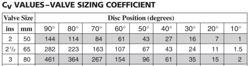

Edit: Good catch on the degrees vs % open. I'm so used to looking at control valve charts as Cv versus percent travel I didn't see that.

Okay, I understand what you mean - I was thinking you meant putting the control valve downstream of the pressure sensor as well, but upstream of the users, and didn’t see what that accomplished. That would mean only about 9 psi dP available for the valve, so a larger butterfly could be used to avoid the cavitation.
It’s still an iffy thing, in my mind. That’s about 350 gpm per pump during low usage, which is quite far back on the curve. I need to look back at the oem manual to see minimum flow requirements. Otherwise it would also need a min recirc line.

Normally you're looking at 30 to 40% of BEP flowrate as min flow so at>50% you will be fine.
